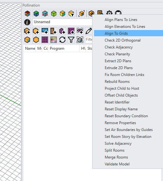

Is there any plan to expose these rhino pollination commands to the grassopper plug in or via honeybee components? This command is one of the most powerful model clean up tools in Rhino that I find myself using on almost all rhino based projects. Having this method accessible via a honeybee GH component aswell would be great. eg brep input to snap, grid lines input as curves to snap to, tolerance, angle etc…

Finally, the title of the topic includes PO_AlignInPlan but the screenshot highlights PO_AlignToGrids. Which one are you hoping to be exposed? :slight_smile:
I believe the Align to grids button in that screenshot actually triggers the PO_AlignInPlan command, as PO_AlignToGrids is not a callable funtion from Rhino…

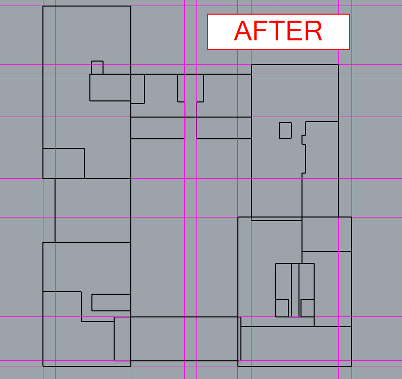

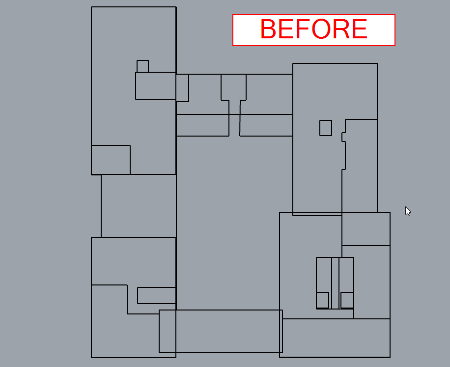

I have actually been running this align to grids command on raw rhino geometry (no need for honeybee geometry at all) as it is just a useful tool for snapping geometry to shared grid lines.

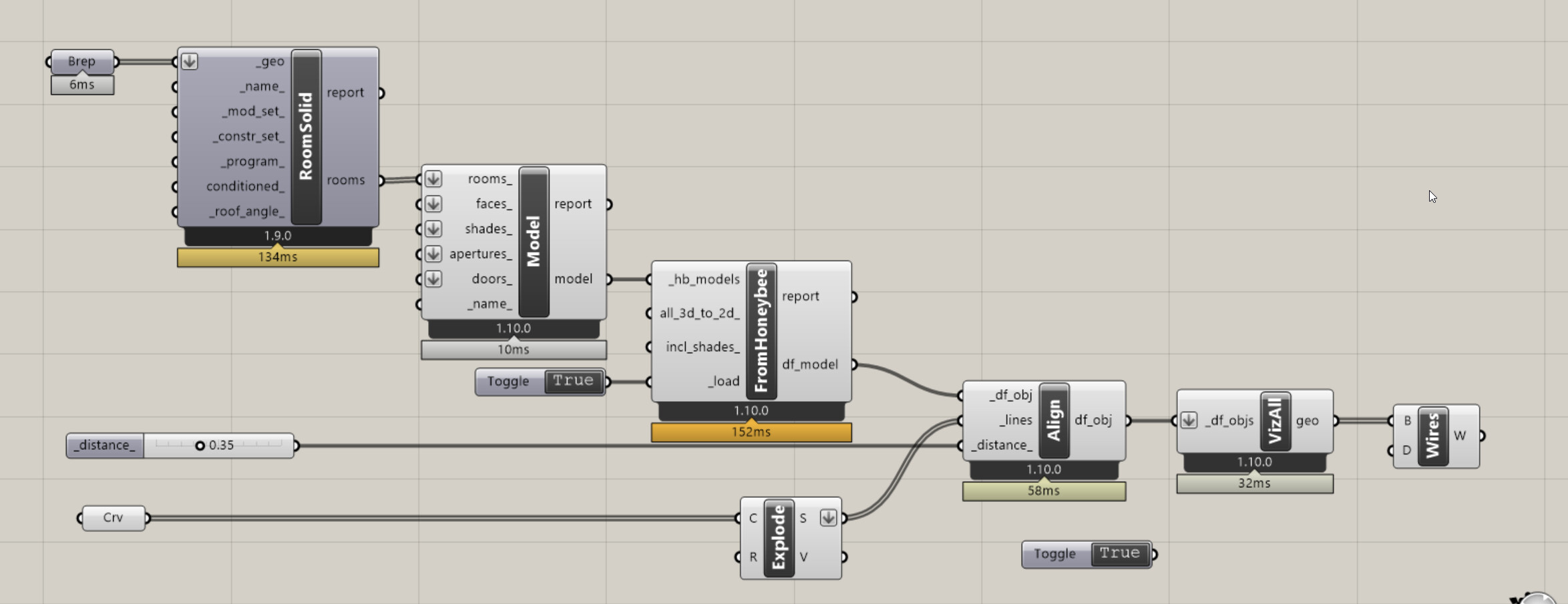

This works a treat! Wish I would have known about this a few years ago!
Glad that you found the DF Align component, @milog.
I was going to say that a lot of these functionalities for geometry cleanup are available as Dragonfly components. And those functionalities that are not yet exposed as components can usually be accomplished by using the Dragonfly Python SDK if you need them in Grasshopper.
