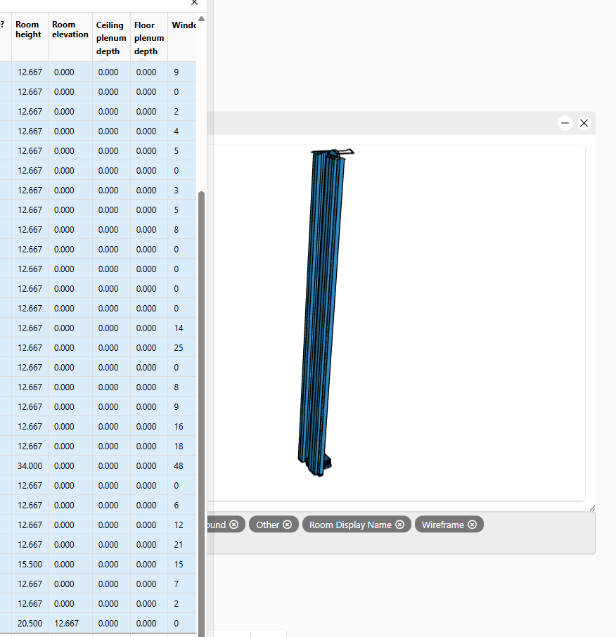

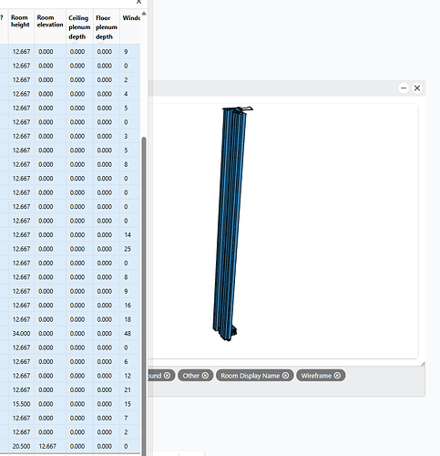

I am attempting to adjust the models level elevations inside the editor. The rooms/levels correctly move to the location but the roofs/shading objects do not move. The resulting model looks like this:
