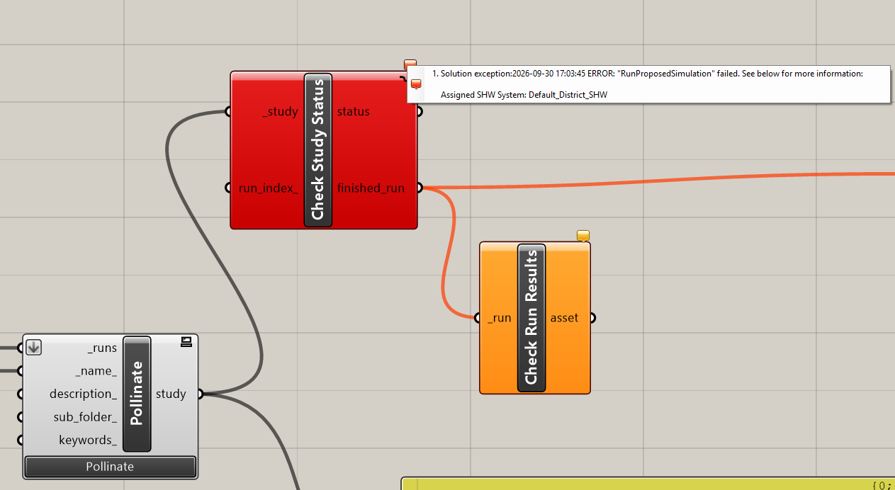

The Appendix G recipe is turning red after failing to run the proposed model. Initially I thought it was due the HVAC system (due to various severe warnings during sizing), but it seems that something related to SHW/DHW is the culprit. This is the error message:
The screenshots are from a run I tried without any SHW systems assigned as a test. The recipe also failed when the zones were assigned electric resistance and HPWHs. I’ve confirmed we have a hot water scheduled to all assigned zones.

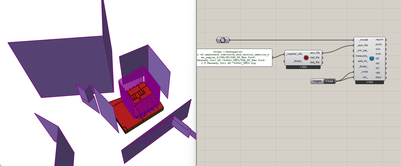

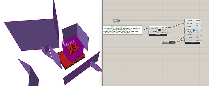

What is interesting is that I did get results from the ‘ModelToOSM’ component, which maybe means this is a bug?

Hi @vitorleiteg, thank you for creating this new topic. Can you share the full log with us? You can find the file inside the folder that you ran the study.
@mostapha Thank you for being so active. The quick replies are truly appreciated! Please see logs attached.
err.log (140 Bytes)
logs.log (790.0 KB)

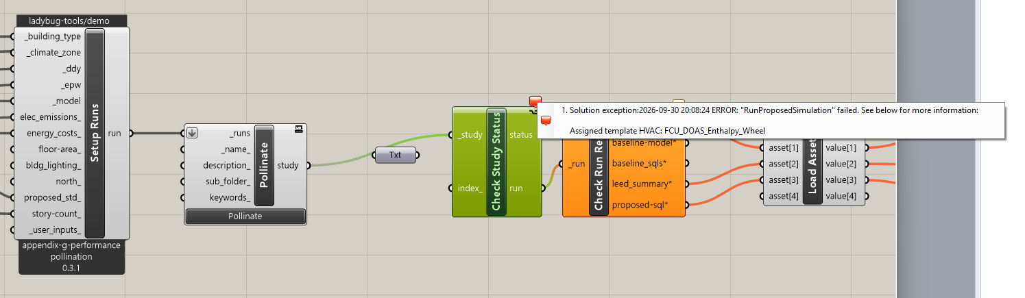

I’ve tried running the ‘appendix_g_sample’ file and I got a similar problem
"Solution exception:2026-09-30 20:08:24 ERROR: “RunProposedSimulation” failed. See below for more information:
Assigned template HVAC: FCU_DOAS_Enthalpy_Wheel"
Is there the possibility something is wrong with my Pollination install?

I am not able to recreate the error on my end. The recipe executes successfully as does a regular old energy simulation with the LBT-Grasshopper Model To OSM component.
