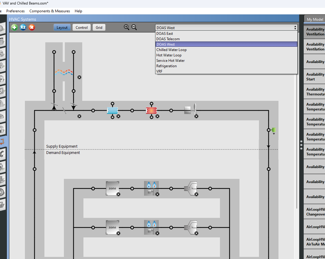

I cannot really find a way to recreate your issue on my side. I can see the system is generated and checked within the OpenStudio Application:

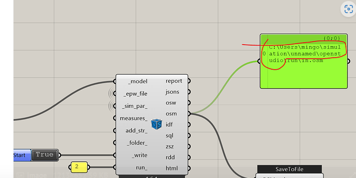

When you set the _write to true, could you please zip this folder for me so that I can look into your files?

Here is the zip of the folder generated from the ModelToOSM component with run_=2:
openstudio.zip (4.8 MB)
