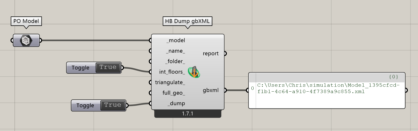

Glad to hear it. I just merged in a change that allows you to set all of the interior horizontal faces to be an InteriorFloor:
It’s exposed on the latest HB Dump gbXML Grasshopper component if you want to try it out yourself:
Otherwise, @mingbo can expose it on the “Save As gbXML” capability of the Rhino plugin as soon as he gets the chance.

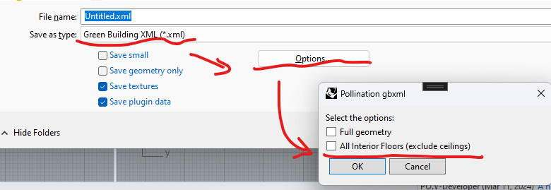

Hi @piusto, in the next release version, this setting will be available for exporting the gbxml.

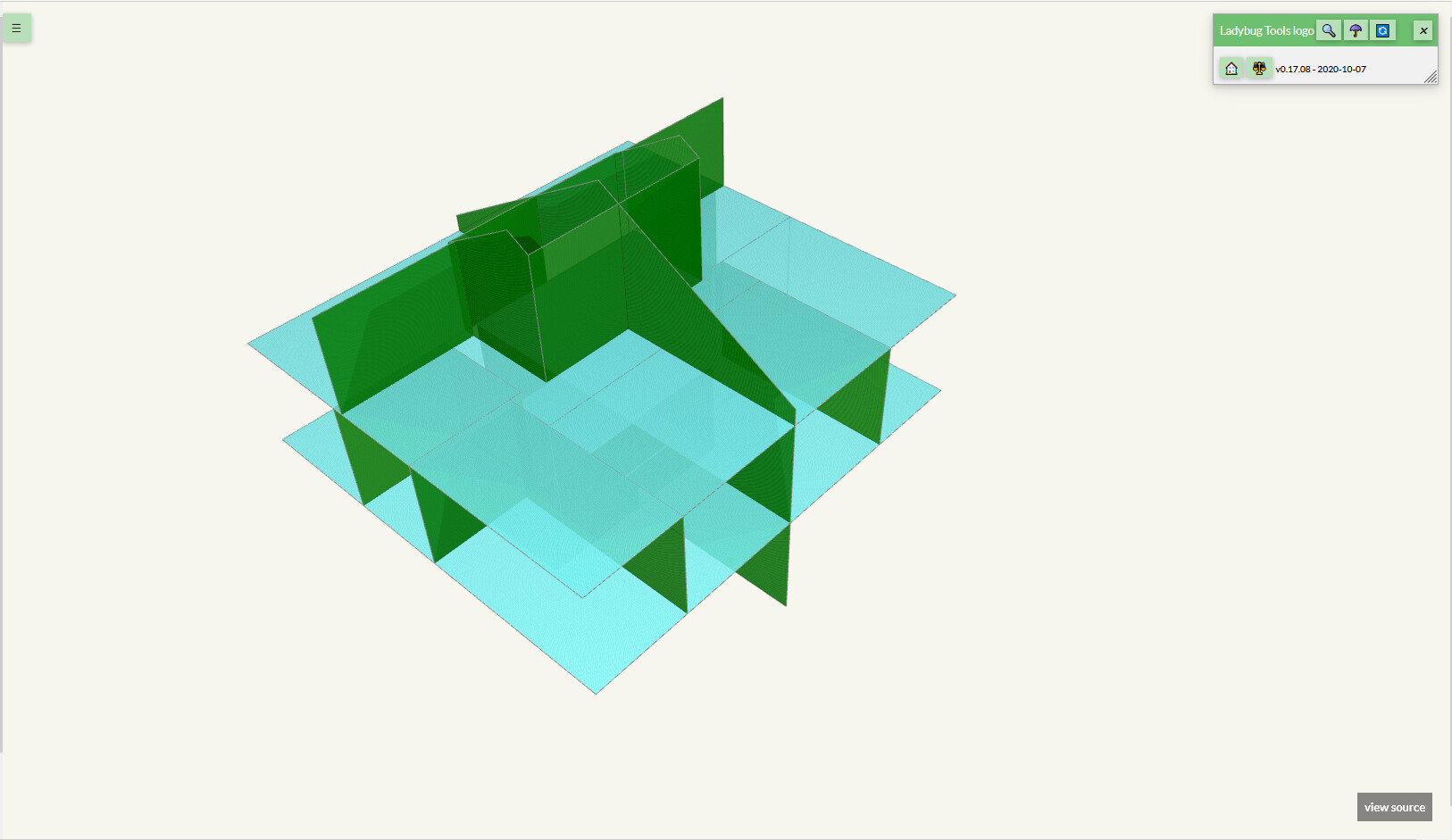

@piusto, the new version is now publicly available (v1.43.12). It includes the option that @mingbo mentioned above and here is what the exported gbXML looks like.
Keep in mind that the option is not selected by default, and you have to select it when it exporting the model to gbXML.
Es 1.3.3_Pollination_Solve Adj_B_Int_Only.xml (225.1 KB)
