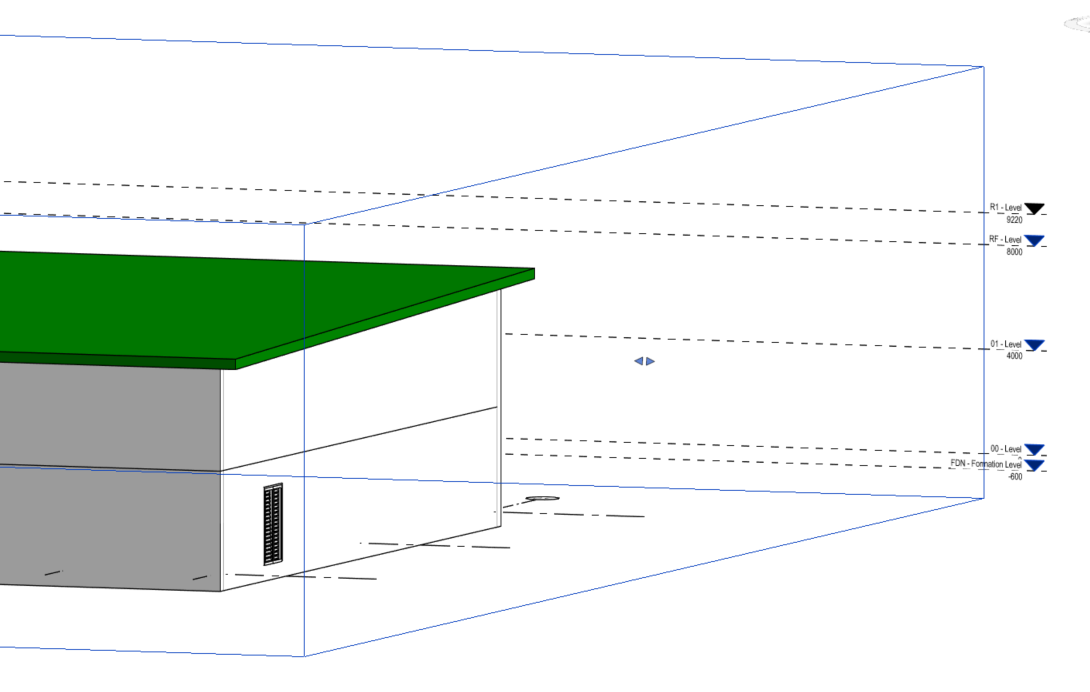

How do I adjust the building height so that it slopes between 8000 to 9220 on the other side of the building?

Hi, thanks for your response. The Revit model already has a sloped roof (as shown in the image I attached - from 8000 to 9220) but when I bring it into Pollination, only the lower part of the room height is picked up and a flat roof is created, I want to make it into a sloped roof within the Pollination tool

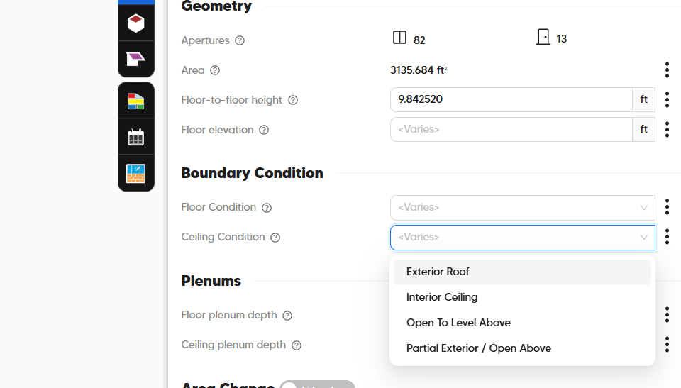

I see. In that case, you need to:
  1. Import the roof(s).
  2. Select the rooms with sloped roofs and set the Ceiling Condition to Exterior Roof
