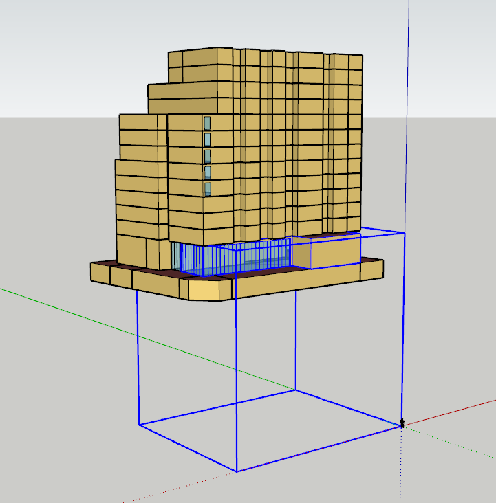

Hello,
I export my model from Revit to Model Editor and from there I export IDF file for OpenStudio and somehow in between it changes the Z origin of my spaces and my model is up in the air eventhough in Model Editor I choose the basement and set “Ground contact” to “true”. Does anyone know how I can fix that?
Thank you

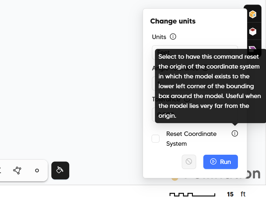

This is happening because of how the model is created in Revit. Try to use the “Reset Coordinate System” command in the Model Editor and re-export your model.
It is part of the “Change units” menu.
Let me know if you have any other questions.
Awesome it worked! Thank you so much
