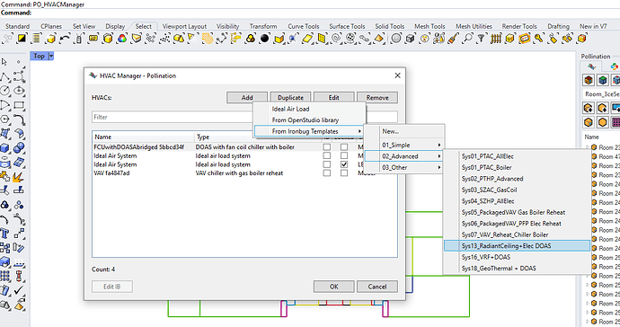

Yes. Once you have it set up the first time then you can reuse the Grasshopper definition. You can change the input parameters as needed starting from the template. Try the PO_HVACManager command, and you can see some of the available templates.
And check the available input parameters. Here is an example.
You can also build your templates as needed. The videos should cover the steps for building an HVAC system.
You don’t have to watch all the videos unless you like to. Watching a couple of them should give you a sense of the logic behind the Ironbug. :smile:
