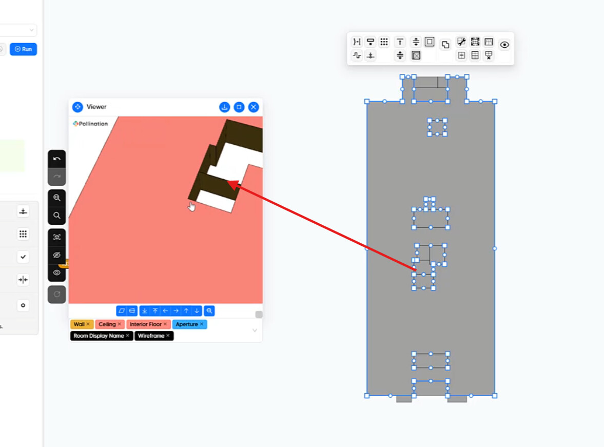

I’ve been able to successfully export models before, but on this particular model, I click export and the Run icon continues to spin indefinitely, with no GEM file ever being created. The same thing happens on Model Viewer classic and V2. The POMF file is only 544 KB. Any help would be appreciated.
Hi @clarkd78,
Sorry about that. Can you share the PoMF with me? Everything looks fine from your screenshot. You can email it to me or send it in a private message if you don’t want to share it publicly.
Also, what version of the Revit plugin are you using?
Hi @clarkd78,

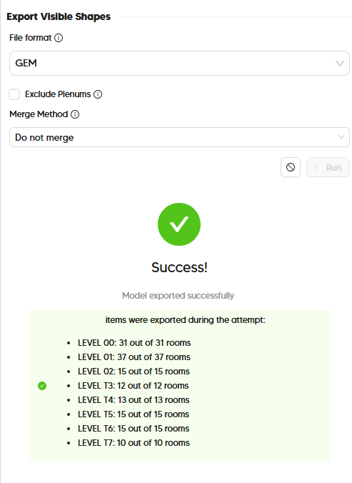

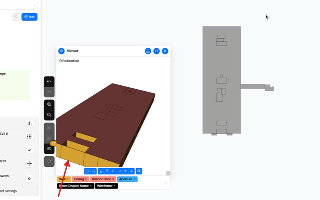

Thank you for sharing the model with me via email. I just shared the fixed model with you, with a recording that shows how to fix the issue.
The problem was caused because of the two rooms that had line-like segments. One on the 2nd floor and another one on the 5th.
Part of our routine tries to breakdown the faces with holes (since IESVE doesn’t handle them natively), and in this case, having a line-like segment was causing the algorithm to get into an infinite loop. After removing the problematic segments everything works as expected.

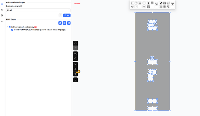

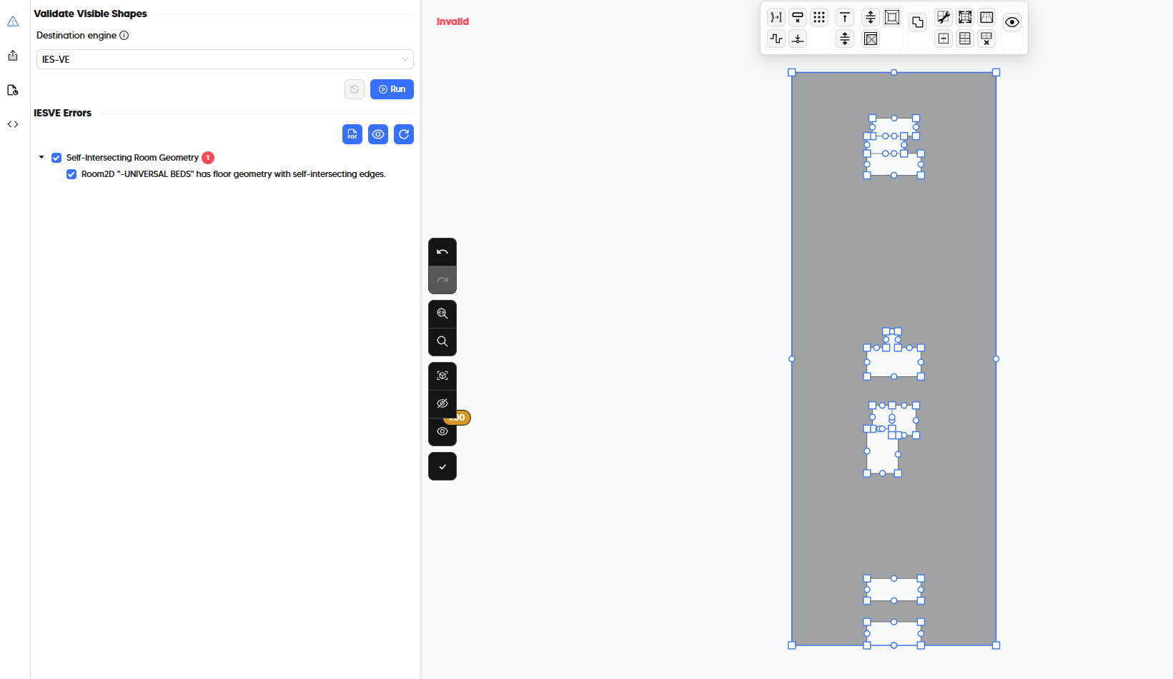

I know that we are a couple of months later but I’m just letting you know that we addressed the original issue that you experienced here. Now, when you have a room where the holes are touching one another, you will get a “Self-intersecting Room” validation error to alert you to the fact that this should be fixed if you want a result that imports to IESVE without issues:
Furthermore, I have revised the routine that handles shapes with holes in the GEM exporter such that the exporter will not get caught in an endless loop while trying to export to GEM.
