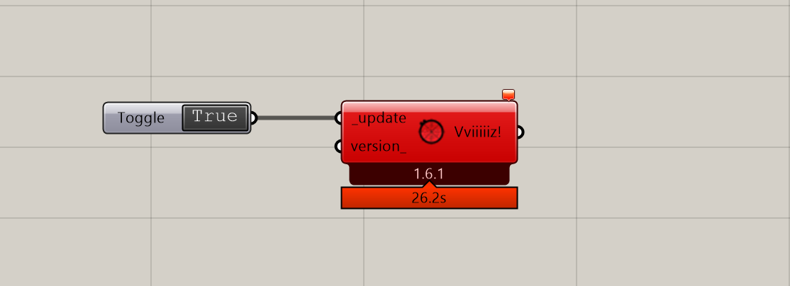

Hi @vanageso,
If doing as shown in the image below does not work, please try the following:
  1. Download dynamic.py (8.0 KB).
  2. Go to the following folder C:\Program Files\ladybug_tools\python\Lib\site-packages\honeybee_radiance_postprocess.
  3. Replace the file called dynamic.py with the one you downloaded in step 1.
