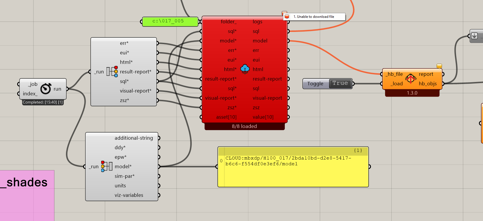

Hi all
I also struggle with the download
First i have difficulties to handle this setting in a way, not to have the previous setting files installed again in a sub folder of my choice before I can install the desired one.
The provided sub folders are not really of any use. Having 20 of these encrypted ones in a project file I don’t how to figure out the content?
In this case the files are already downloaded to the folder except for the visual report. Would be helpful to know which one is failing.
I was going to suggest you using several download components to download these resources. That way we will know which one is causing the issue.
Or maybe make both ways accessible, the existing one and single components?
That’s related to this topic
for the Check Job Status component I have the workaround to disable it before setting a new Folder. But with a “sense making” Folder structure in general, it may not necessary to change something about it?
