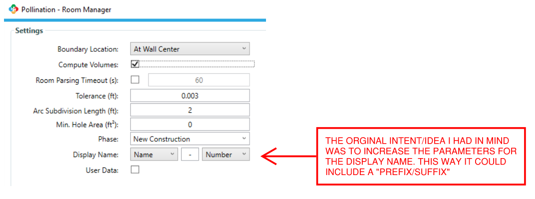

So let me circle back to my first post in this chat. The intent in being able to “denote room/space types…” was to be able to include more information as part of the display name like shown in the image
This allows the user to be in control of how they want to sort the spaces. Including the Level or Space Type as part of the display name simply acts as a sort of Prefix. This is due to Architects having a plethora of rooms that may/may not follow a naming convention.

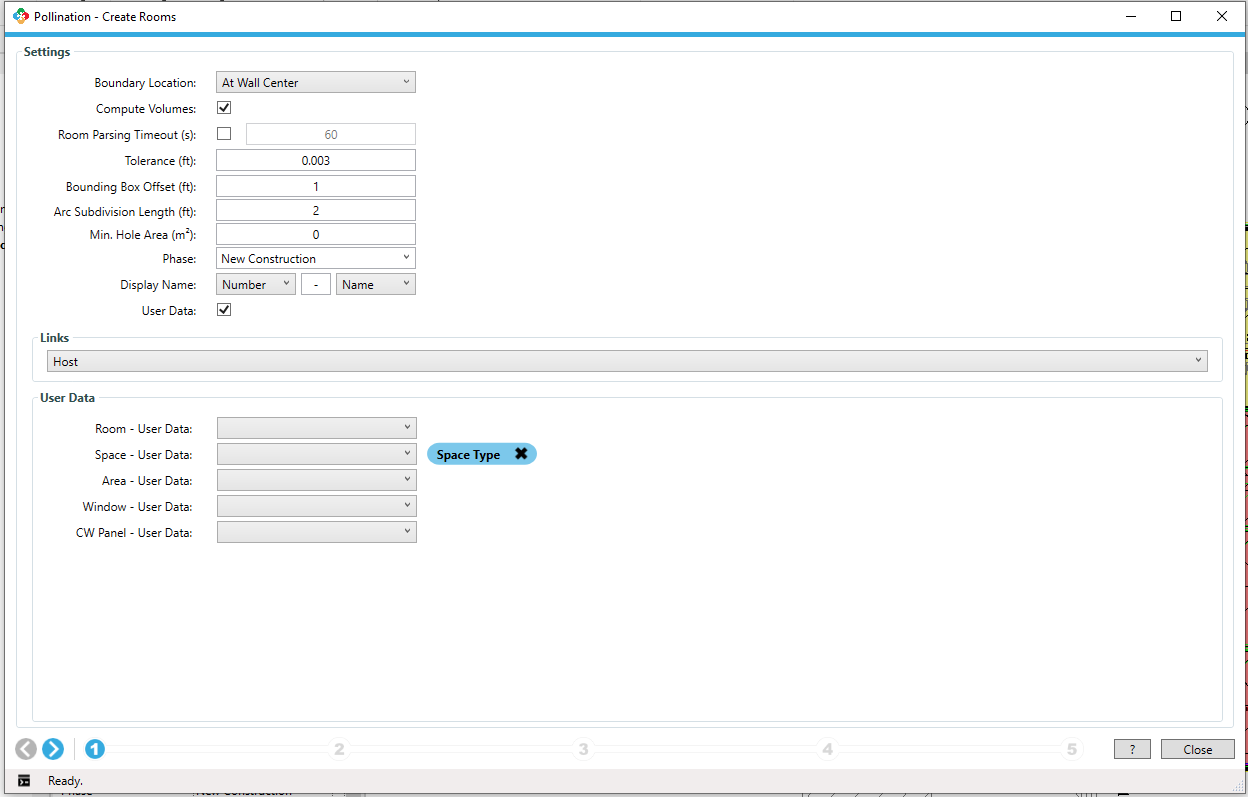

This has been already addressed by adding the Python Script Editor to the Model Editor in August last year. I mentioned it in a post, but I realized I never left a comment here.
The process does what you asked for above by renaming the Pollination rooms inside the Model Editor.
Here is how it works.

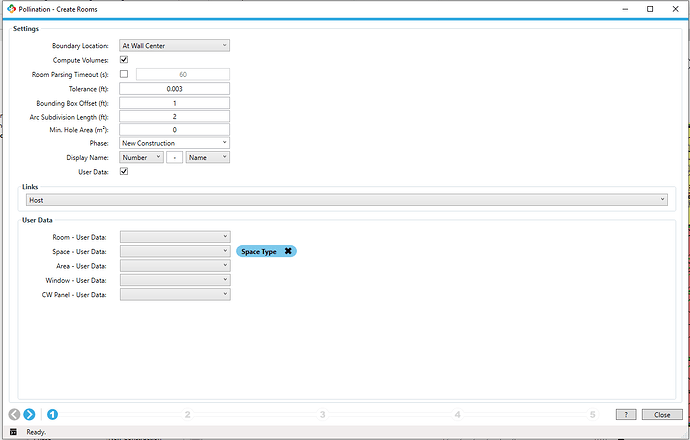

  1. Select the property to be exported as user data. In this case, Space Type.
  2. Use this Python code to rename the rooms based on the Space Type.
