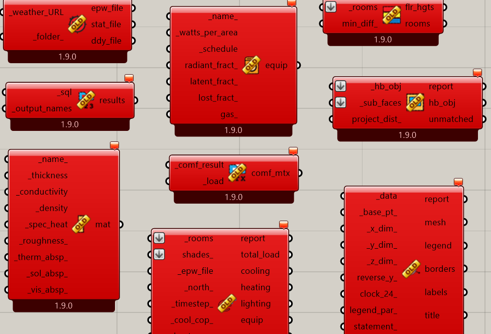

After installing Pollination, all LB, HB and DF plugins went red + are leabeled OLD

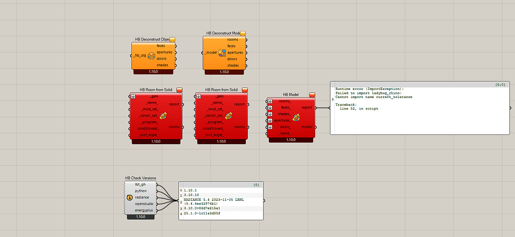

Hi there, I’m a bit stuck here. I’ve been working fine with the LadyBug 1.8.0 version, then updated to 1.9.0 a month ago. Then I’ve installed Pollination and all the Grasshopper components turned red saying:
  1. Solution exception:No data is available for encoding 0. For information on defining a custom encoding, see the documentation for the Encoding.RegisterProvider method.
I tried even the latest Pollination version (plugins_release_PollinationGHInstaller-1.66.28) but the problem persists.
