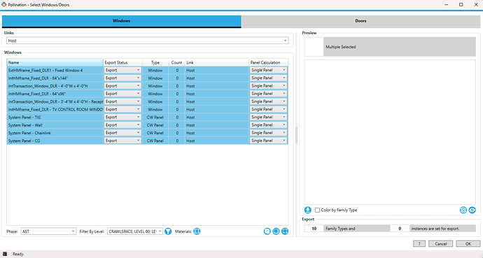

All windows count are 0
Hey! I think I’m having a similar problem where my windows and doors arent showing up with all being count: 0. Here’s the screenshot and log. I’m in Revit 2024

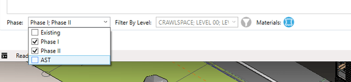

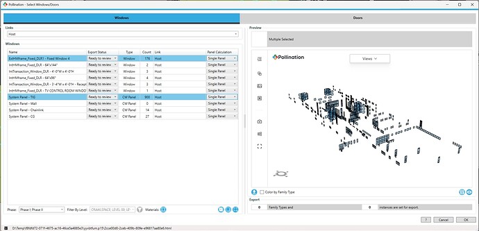

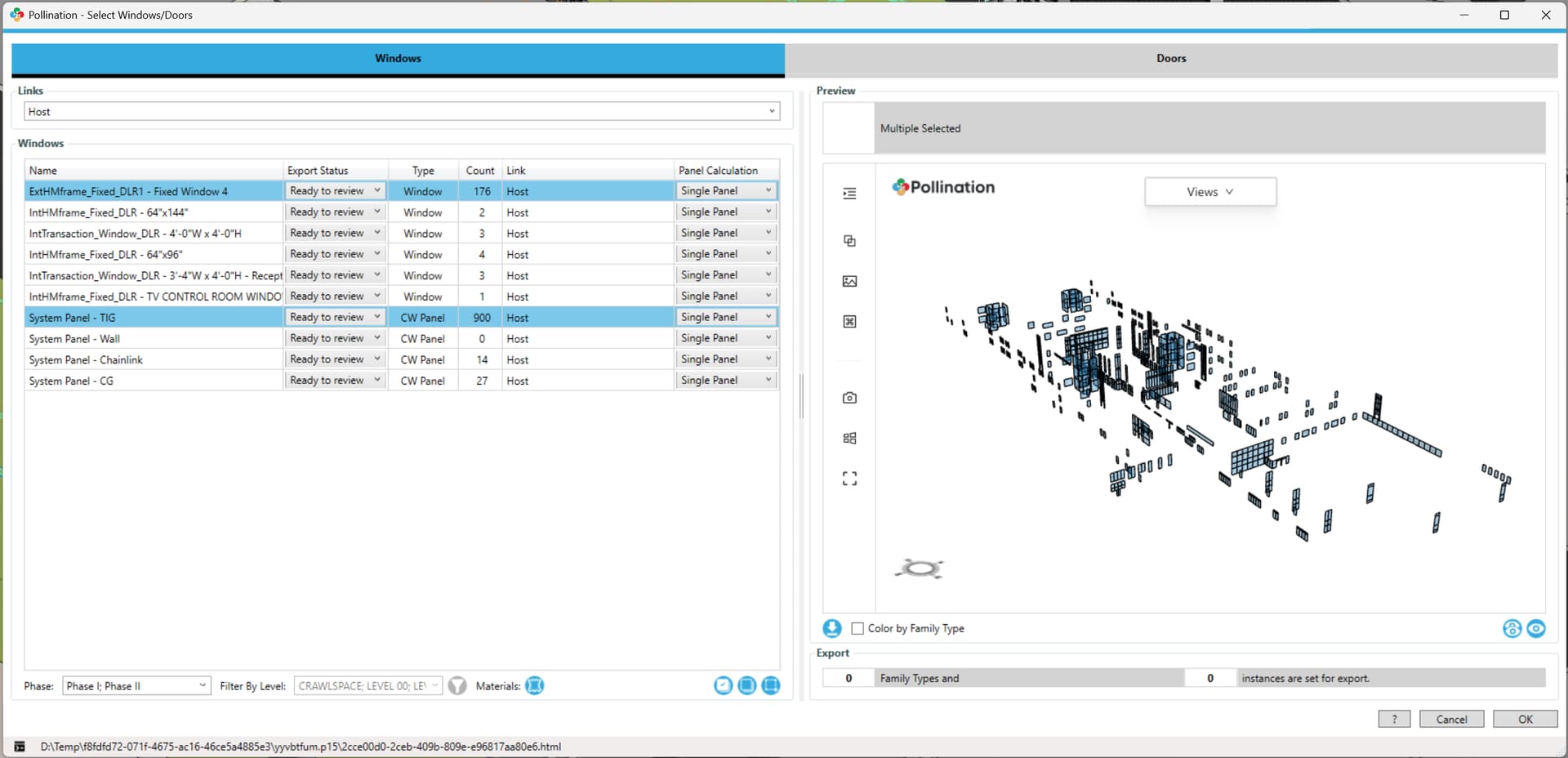

Thank you for sharing the model. I’m going to send you a recording shortly, but in your case, you have to select the correct phases and the windows will show up.
Here is the preview.
