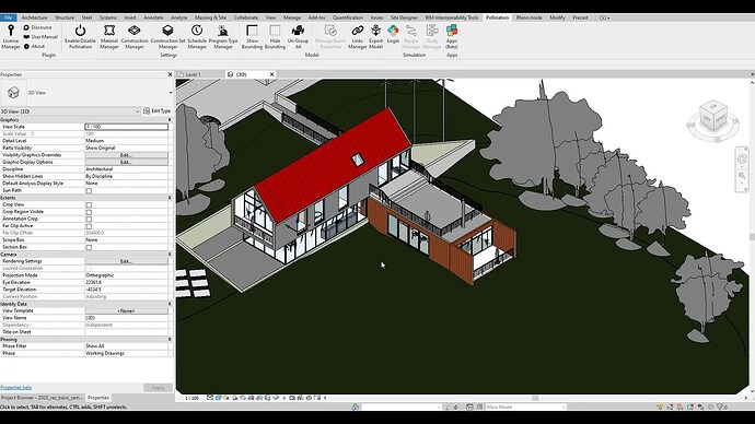

If you are like me who has to work with Revit models that are created by other people, you probably know the pain of figuring out the apertures that are included in the model. It can even get harder if you are dealing with a large model and exporting the model level by level and you need to know what apertures to pick.
Two improvements for aperture selection
We have made two improvements to the Revit plugin to make your life easier:
  1. The Revit plugin now only includes the objects that are placed in the Revit model. This will remove all the unused objects from the list.
  2. You can now right-click on each row and try to select them in the Revit model. This feature will give you a quick way to inspect the model before choosing the apertures.
