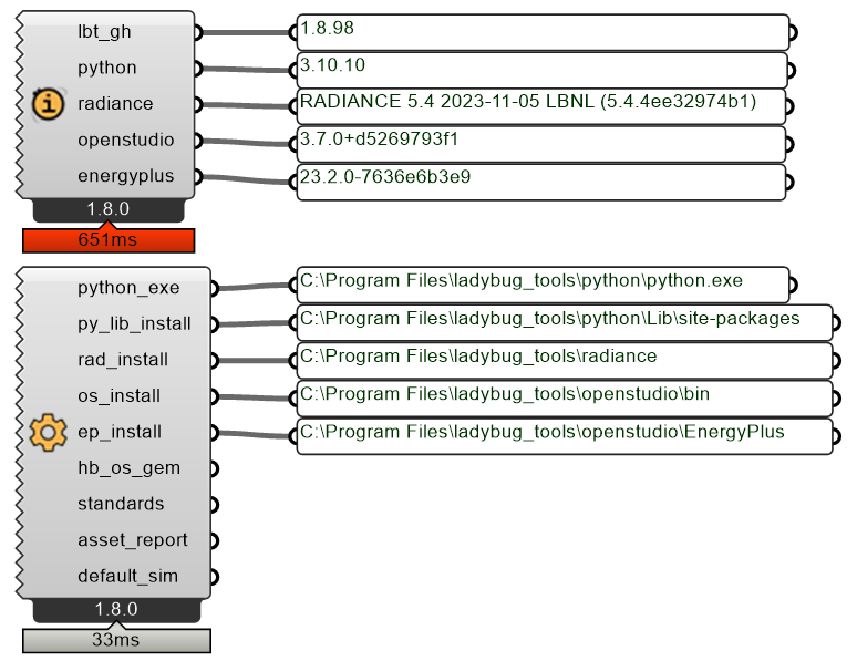

I tried updating my LBT install to the latest version, no luck.
This is my current setup:

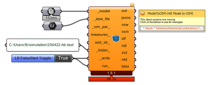

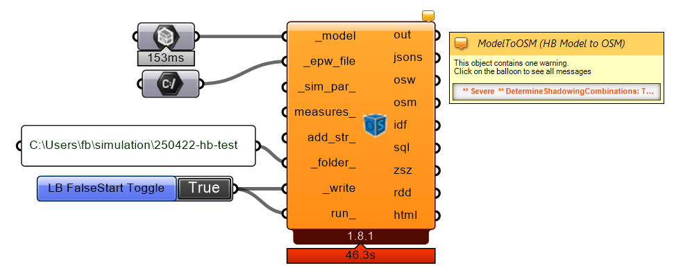

If I load the model to Honeybee, I can run it without any fatal issues...

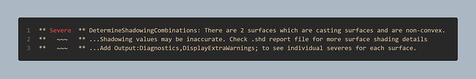

…the Model to OSM component is moderately happy, but the 2 severe errors are unrelated, those are due to non-convex surfaces, I’m not yet concerned about them:
