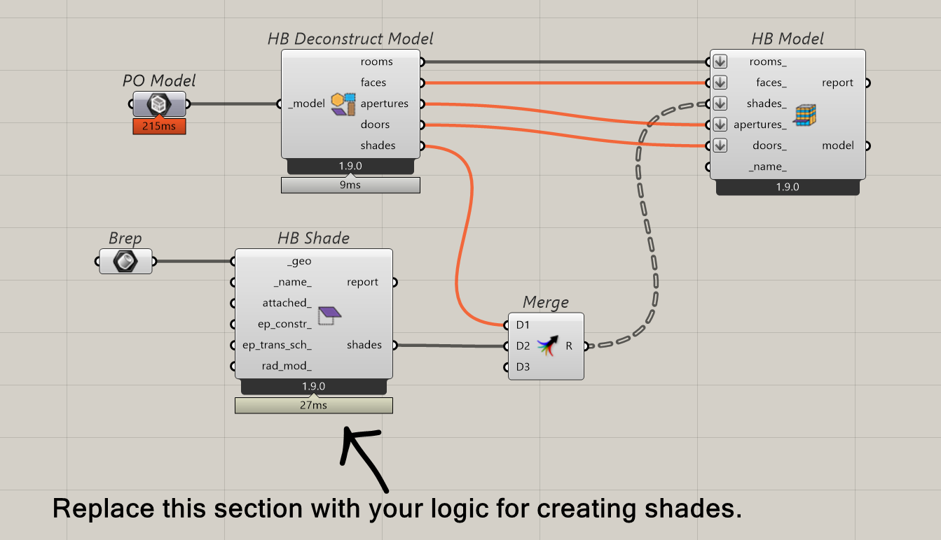

I have set up my model in Rhino and exported to my Grasshopper script. Now I wanted to add apertures shading elements to my model in grasshopper (will need to do parametrisation study with these shading elements). Is there any way I can assign these shading element to my PO Model inside grasshopper?
Hi @fedosde,
@chriswmackey might be able to provide a better answer but this is how I have done it in the past.
thanks @mostapha, i did the same way and it worked, was wondering if there is a better component to use that i could miss
Those are the recommended components, @mostapha .
@fedosde , what would be better than the components in the screenshot? You want to use one component instead of 3 or something like that?
