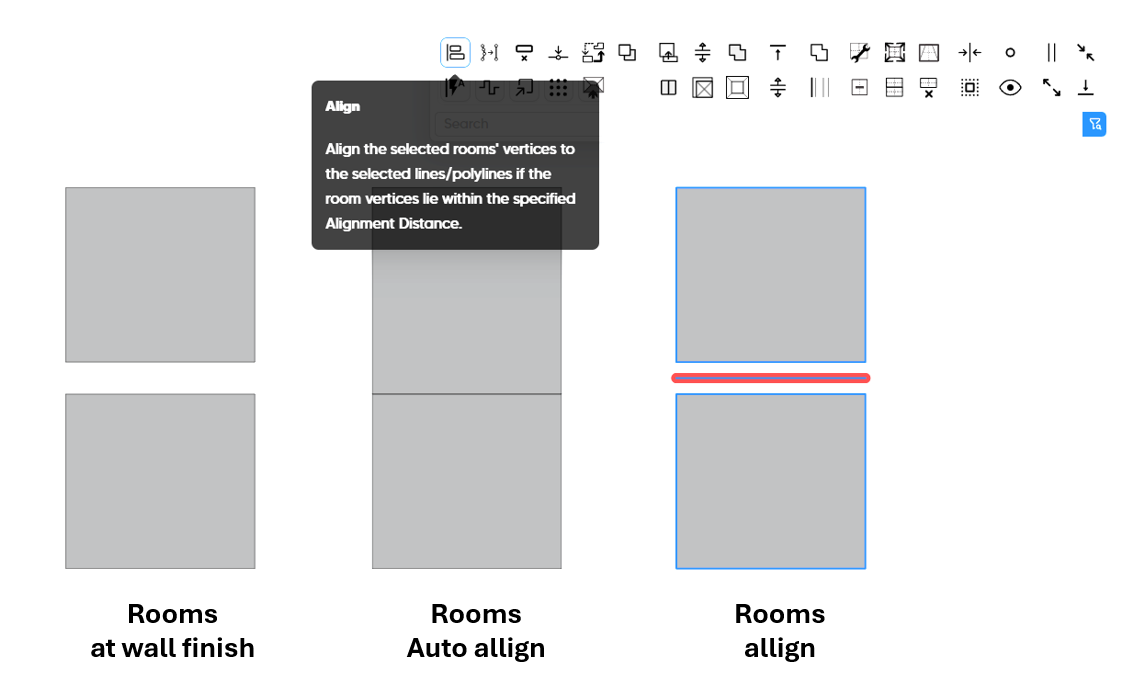

According to our current Revit workflow we need our rooms to …
  1. Outer walls: start at the inside of outer walls
  2. Inner walls: start at the centre of inner walls
Since our BOQ is obtained from Revit, we need our rooms to remain “at wall finish” (this complies with requirement 1).
In a later phase (in the model editor) we use auto alignment to affect the rooms (to comply with requirement 2). Now, I have seen that one of the rooms remains unchanged, but that the other room is aligned to the first room (figure 2). However, we need both rooms to allign to the centre of the wall. Is there an efficient way to do this or do we need to draw an alignment line in the middle of both rooms to make this work (figure 3)?

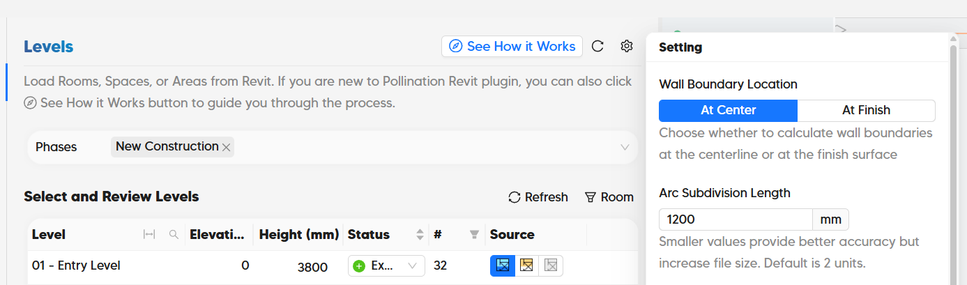

Hi @thibaudve,
Thank you for posting your question on the forum.
I understand the requirement. I suggest using a different approach here. You can start with using the At Center option for Wall Boundary Location which provides the requirements for the Inner Walls.
Then use the floor boundary to offset the exterior walls inwards to meet the Outer Walls requirement. The documentation here explains the process:
Let me know if you have any follow up questions.
