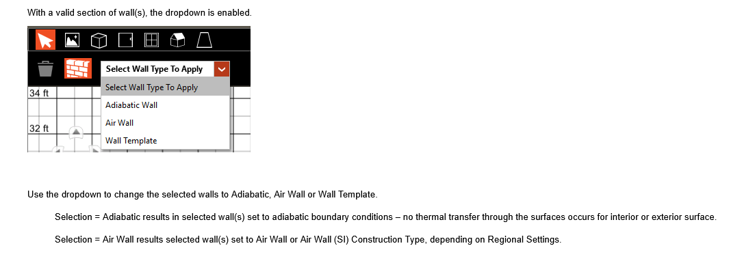

Are you trying to set the boundary condition to interior so you don’t see any heat transfer from those faces? On solution to address what you need is to define those walls as adiabatic. Since TRACE 3D Plus is based on EnergyPlus they should have this concept.

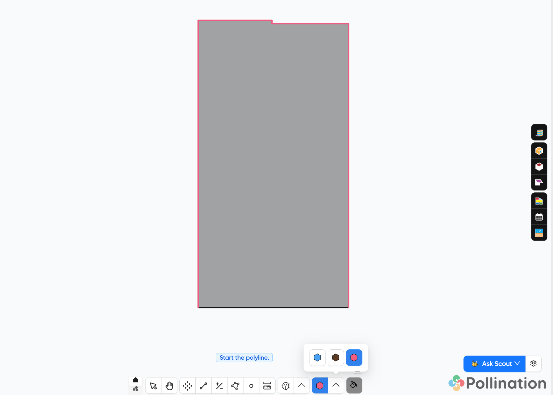

We currently don’t have it exposed in the current version of Pollination, but this will be available in the next version. Here is how it looks like.
Let me know if you want me to help you with exporting the room for you with adiabatic walls and see how it will show up in TRACE 3DPlus. Since it is only a single room, it is probably easy enough to set them as adiabatic faces there. I found this online:
https://trace3dplus.help.trane.com/selection_tools.html
