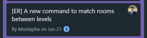

This is a great feature request, and we already have a card for it with a slightly different approach. The problem with copying the rooms is that your snapshot will get out of sync with your Revit model, which is not desired, and can break other workflows like comparing changes in the next versions of the Revit model or reading the simulation results back to the Model Editor and copying back to Revit.
Our plan is to add a new command to compare and match rooms between different levels. :backhand_index_pointing_down:
This command will allow you to match the selected rooms on different levels with the rooms from a base/guide level. This way, you keep the name and identifier of the original rooms but re-use the work that you have done on one level for updating the geometry of the rooms on the other levels.
@chriswmackey is currently OOO but this is on top of the list for when he will be back. We will keep you posted on our progress.
