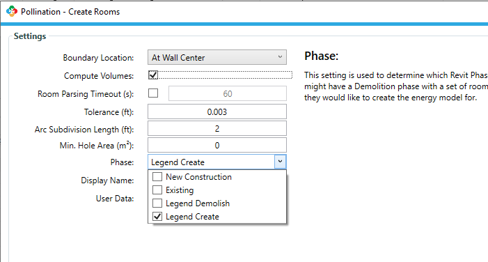

Can you be more specific about what doesn’t work? Can you share a short video or a screenshot? It feels that you might be selecting the wrong phase for the project.

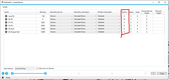

Do you see the correct room count in the second step?

Thanks for the quick response - for me the phase selected is “New Construction”? That is the phase Revit has the rooms set to - if I am understanding correctly - I will share images

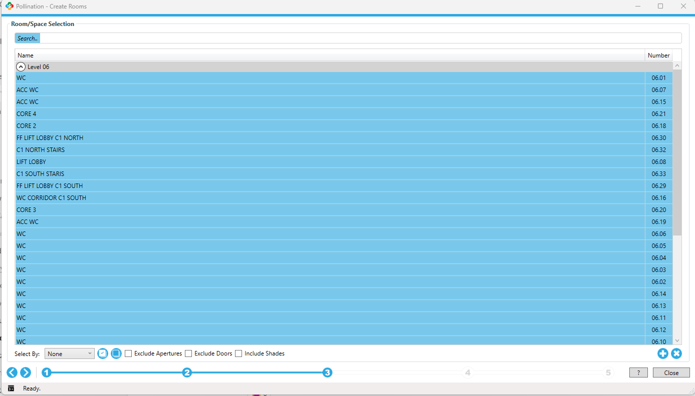

Rooms shown correctly
Rooms showing up in Step 3

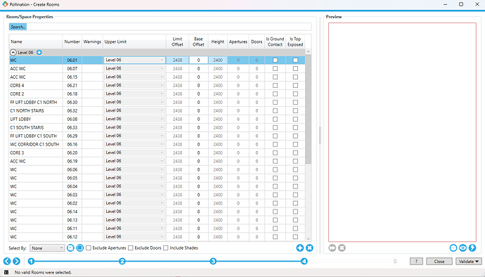

Rooms parsed, but nothing showing up on Preview - if I select all rooms and try to generate preview, Revit hangs for a long time, and crashes - tried 4-5 times with different rooms individually - some rooms preview successfully but some rooms don’t, leading me to believe some rooms are causing some unidentified issue?

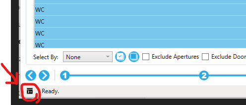

  1. Can you share the log file with us? That might be enough to identify the issue. You can find the file by clicking on the small block square in the menu.
