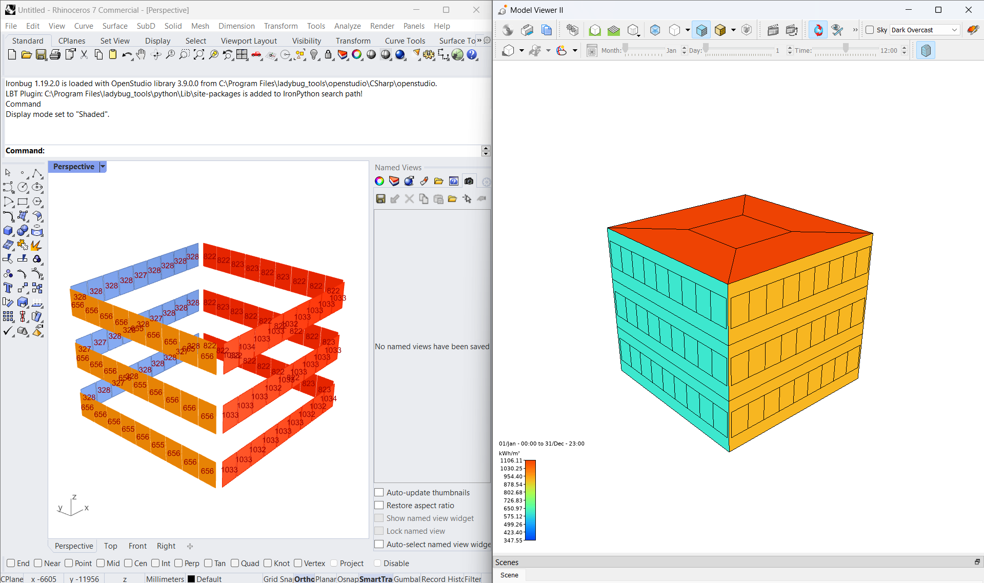

Dear colleagues,
I’ve made a quick analysis of the solar radiation falling on the building facade, and I get disagreeing results between IESVE and Honeybee. This is the overview with the color:
and this is the overview per orientation:
radiation per orientation
rhino
iesve
S
1033
920
-11%
E
822
740
-10%
N
327
350
7%
W
656
610
-7%
Therefore, I have two questions regarding these results:
how does one explain differences of 10% in the radiation falling on the facade?
which one provides the most trustworthy results, IESVE or Honeybee?
Thanks in advance for the input!
