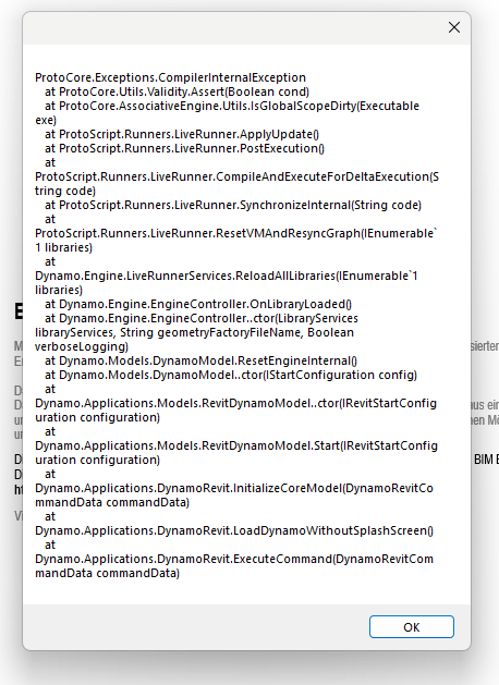

Dynamo cannot be started when the Pollination add-in is installed. Revit 2026.4
I just found an issue with the current pollination version (fresh install) and revit 2026.4 and Dynamo. With pollination addon installed its not possible to open dynamo (visual scripting).

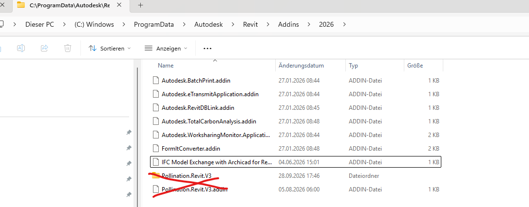

If i remove the pollination addons under:
Dynamo works again.
