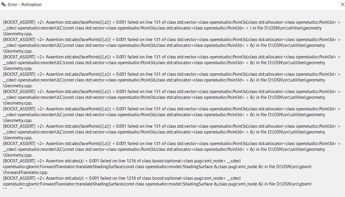

Hello,
I am trying to build a geometry based on the manual being given on the website.
But everytime I export it into GBXML file, there is always an error showing up like the attached image.
Does anyone know what’s causing this?
Hi @ricardolionar,
Based on the error, you’re model is using the wrong units. If I have to guess it’s currently mm but it should have been meters.
Can you change the units and try again?
If that didn’t work, can you share the Rhino file with us?
Hi @mostapha
Yes, I am using mm in Rhino, but the error still happens if I am using a meter
For context, I am trying to simulate a small structure instead of a big building. But the error still happened even if I scaled up my model
It still produced the gbxml, but not sure if the error affected the outcome…
(I am trying to use it in DesignBuilder)
Kindly let me know if I missed something in the process…

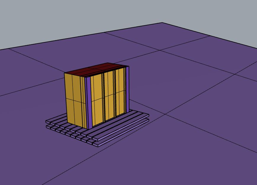

test_draft.3dm (434.6 KB)
Thank you

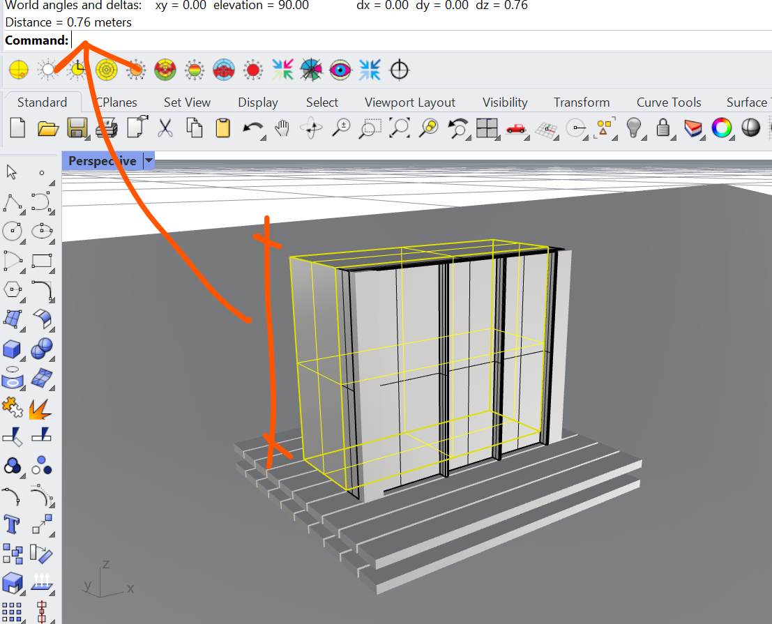

@ricardolionar, the model is still not correct. The total height of your building is 76 cm.
Make sure you scale the model to the correct dimensions before exporting the model.
You should also check if your model is valid before trying to export it as a gbXML. It currently has several validation issues.
Hi @mostapha ,
Thanks for checking it out. The model size is indeed correct. I’m examining parts of the building components, not the entire building. I’m treating this small part as a “zone” to see if the EnergyPlus simulation is accurate.
I understand that most Building Energy Simulations are typically done for entire buildings. However, I wanted to experiment and see whether Honeybee or DesignBuilder, both of which utilize EnergyPlus, are the right tools for this task.
The first step is to export the model to GBXML since DesignBuilder doesn’t allow me to model tiny parts, whereas Rhino does.
I would appreciate any suggestions you might have.

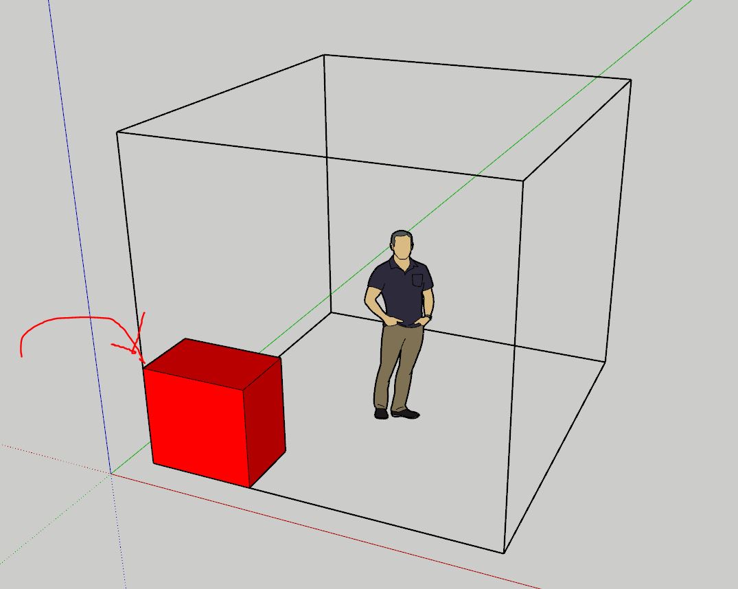

Hi @ricardolionar,
I’m a bit confused. It is fine if you want to test part of the building. There is no such limitation in energy modeling tools. You can start with a single room. Just make sure the dimensions are realistic. A room is most likely taller than 0.75.
Also, the thermal zones should not be modeled on top of each other regardless of the size of the model.
