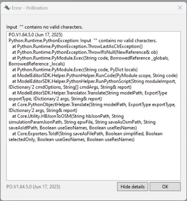

I’m trying to export my Pollination model to either an OpenStudio (OSM) or EnergyPlus (IDF) file for further editing, but I’ve encountered the following error:
“Invalid “” contain no valid characters.”
Has anyone experienced a similar issue or know how to resolve this? I’d really appreciate any advice or suggestions.

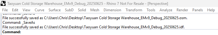

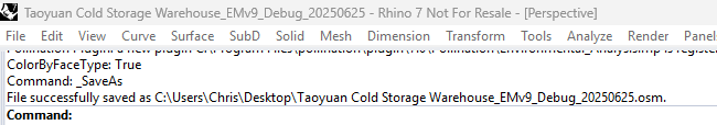

I could not recreate the error with the file that you provided. I was able to save the model to an OSM wihtout issues:
Taoyuan Cold Storage Warehouse_EMv9_Debug_20250625.osm (3.8 MB)
… as well as IDF:
Taoyuan Cold Storage Warehouse_EMv9_Debug_20250625.idf (2.2 MB)
What version of the Pollination Rhino plugin are you using, @tinatuna90 ? I would recommend downloading and installing the latest plugin to see if that fixes it for you.

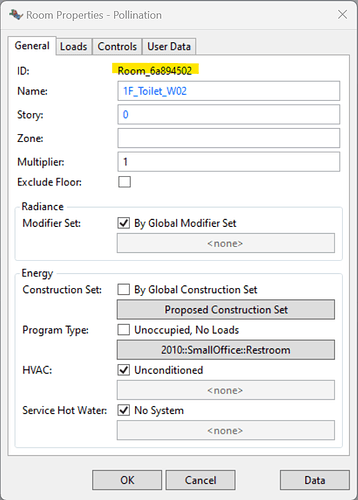

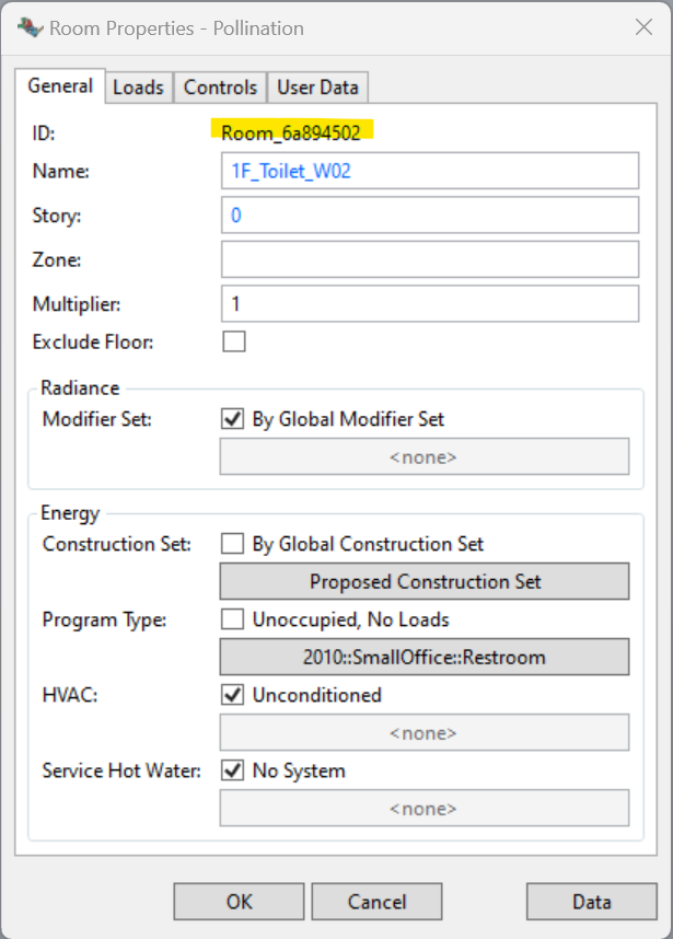

I just realized that the room names displayed in the IDF file are actually the ID. Is there a way I can modify the ID so they match the display names from my Rhino model?
Hi @tinatuna90,
Yes. There is. See here:

The error only appears when I export the IDF file without ticking the Simplified IDF option.
Unfortunately, I need to work with the expanded version, so my workaround has been to run the model as HBJSON on the server and then download the expanded IDF file from there for further editing.

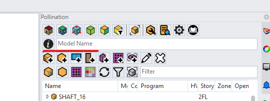

Someone else sent me a model that allowed me to recreate this error message. It probably was not the exact same thing that caused the error for your case here unless your model has no name like theirs (just an empty text string):
In that case, just giving the model a name will fix it. If not, then I’m fairly confident that the fix I pushed will prevent all cases of this error from happening again:
So, if upgrading to the current latest version of the pollination installer does not fix it, then @mostapha can let you know when a new installer is released with the fix.
