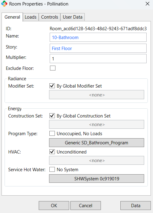

Thank you, @chriswmackey and @mostapha, for your reply, and my apologies for replying to an old topic. Let me describe the steps that I have taken:
I created different schedules for lighting, occupancy, and setpoints for each zone using the Schedule Manager. Then, I defined a separate program for each zone using the Program Type Manager. In the final step, before creating the snapshot, I assigned the appropriate program to each zone. For the bathroom, kitchen, and toilet zones, I also activated the service hot water system in the corresponding window (Please see the picture). After that, I created the snapshot. However, when I clicked the “Import” button in the Model Editor, I encountered a merging error.
