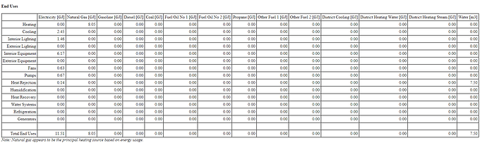

The vast majority of EnergyPlus’s end uses are zero for a typical simulation so that’s why we scrub them out by default. But you can see the “End Uses” table that we pull the data from has lots of zero slots in it if you want them:

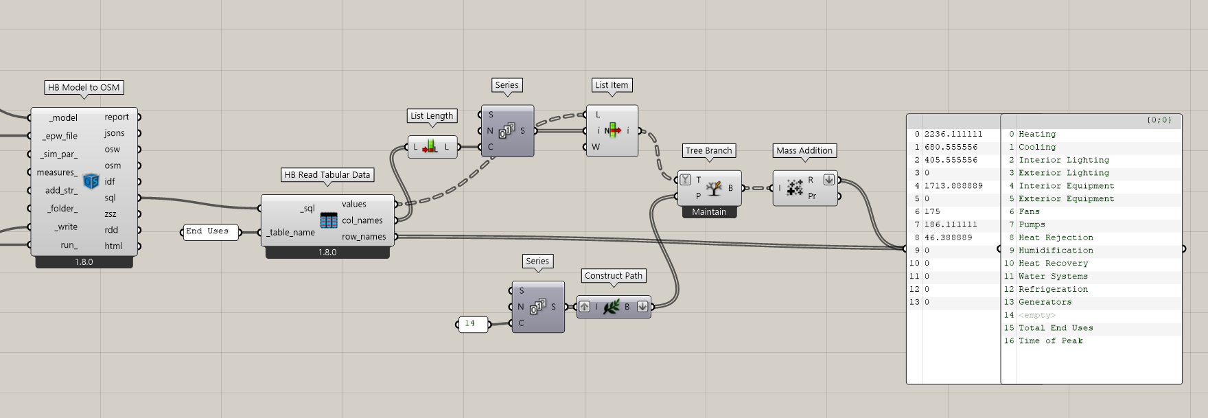

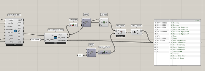

You can just import this data from the sql into Grasshopper using the HB Read Tabular Data component like so:
shoe_box_all_end_uses.gh (50.8 KB)
You just need to do a little processing on the data since E+ throws some extra things into the table that are not energy use (eg. water use and time of peak). But you get values for all of the end uses that E+ can report, which typically means lots of zeros but also means that the same end use is always at the same index.
