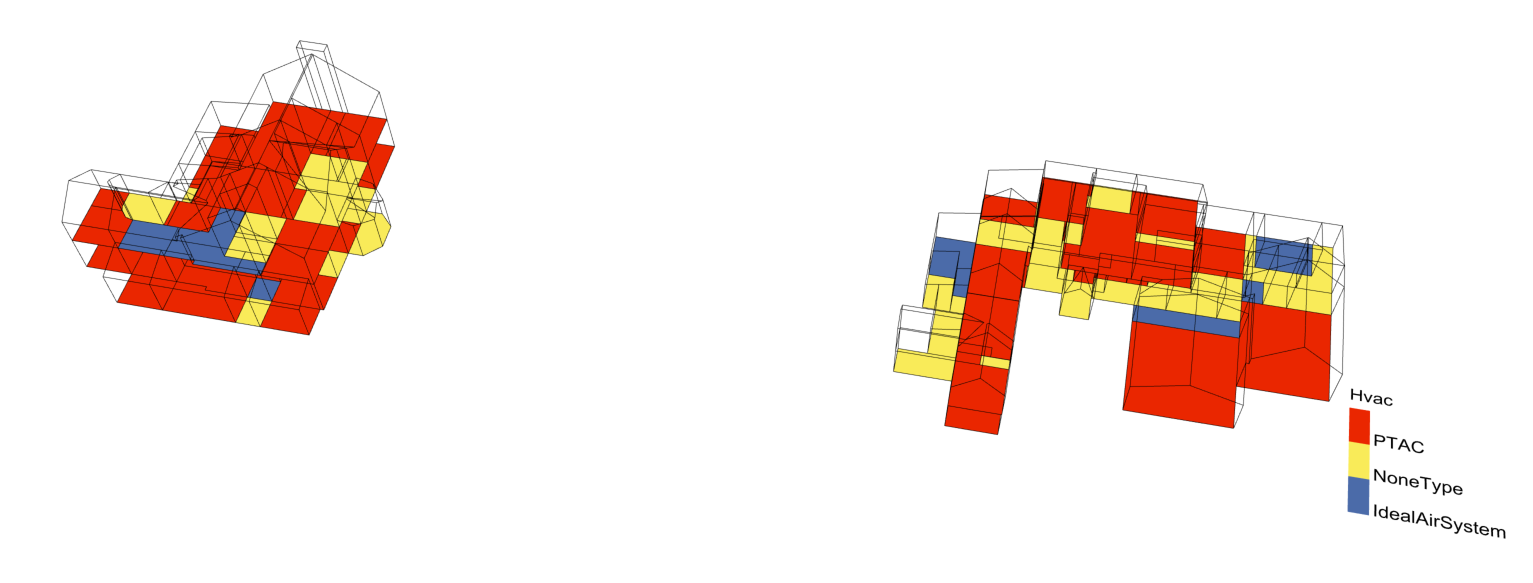

FYI, looking at your model, I see that there are a few spaces with an ideal air system and you should really be replacing these with a real HVAC if you want the Appendix G simulation to be meaningful:
Ah, I figured it out. The ideal air systems are also to blame for the simulation failure. It looks like I should probably add a check in the handler for the recipe to ensure that none of the assigned HVACs are ideal air. But, long story short, just change your ideal air HVACs to be PTAC or something like that and the recipe should succeed.

Also, I have a run going now where I replaced your ideal air systems with PTHP.:
