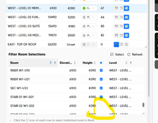

  2. When selecting levels to import - If you deselect certain rooms (so they dont get added to the model), then update any floor’s ‘pending/skip/export’ status, it reselects all your rooms that were previously deselected. This means you cannot deselect rooms working level by level, because once you finish one floor and change the next floor to ‘export’, all those rooms get reselected.

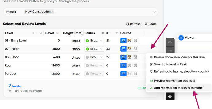

I see your point here. The way the UI is currently designed is based on the idea that you have all the levels to the Model Editor in one go, and then clean them up level by level in the Model Editor. This is a different approach from what we had in the older version.
That said, you can click on each row and only add that level to the Model Editor.
Thank you for bringing this up. We’re overdue for recording a tutorial video for this.
