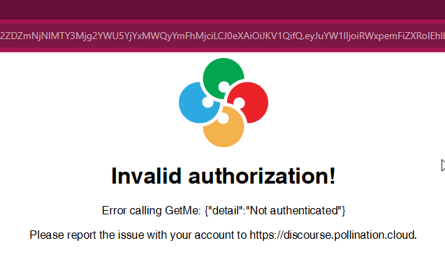

When running a script and logging in for a pollination recipe using the grasshopper plugin, I received this error multiple times.

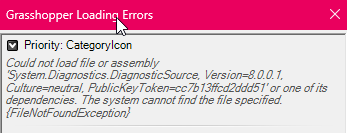

Login was confirmed to function on the web platform, and no accidental google login vs email login error as seen in other posts on the same issue. One discussion post indicated that this had been resolved in the latest update, so I ran an installation of the grasshopper component. Upon opening Rhino and grasshopper, pollination was not loaded and I received this error.
“C:\Program Files\pollination\plugin\7.0\Pollination-GH\Pollination.GH.gha” appears to be installed but not running.
Any tips on what to try next would be helpful.
Hi @eheldridge, can you try using the Rhino plugin installer instead and see if that resolves the problem for you?
Rhino installer loaded grasshopper plugin, and the reinstall solved the login issue. Thanks!
