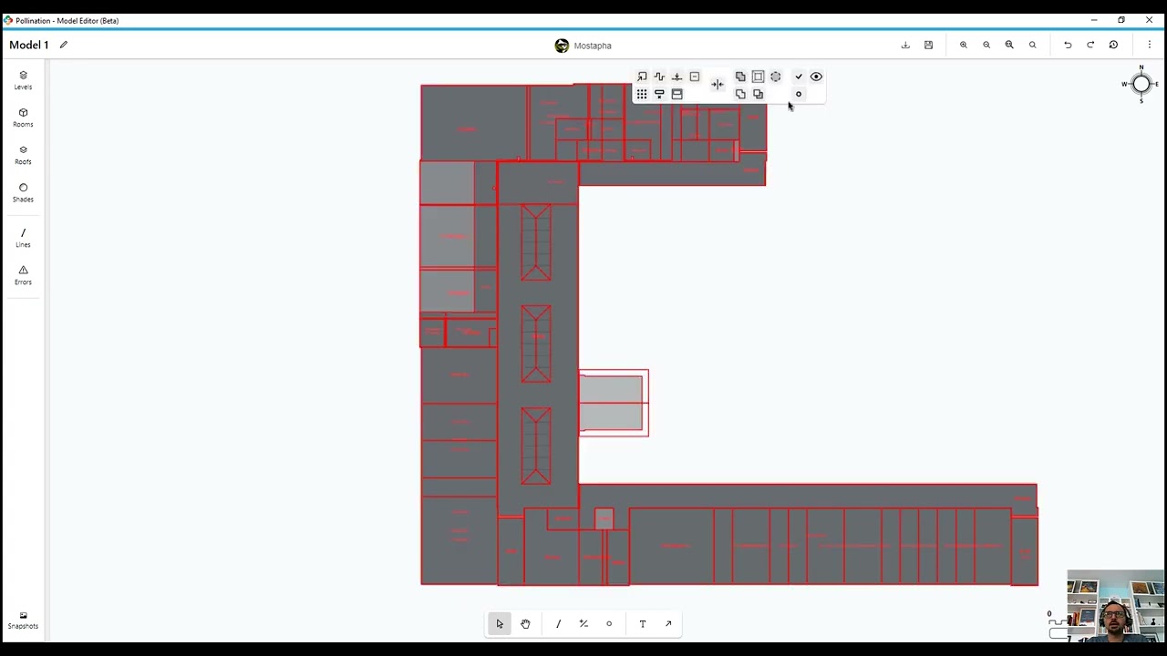

When editing geometry in the Snapshot Manager, it would be super helpful if it highlighted the areas that are invalid (overlapping geometry, self-intersecting rooms, etc). I feel like I am spending too much time on this treasure hunt

FYI, @eschwartz ,
All of the core geometry methods for this feature request have now been implemented and I have routines that can highlight the locations where there are small gaps in the model. Here is an example of zooming into one of these cases:
Zoom 1
Zoom 2
Zoom 3
We still have to expose this as a command within the model editor but, hopefully, you won’t have to wait too much longer for this.
The release is out. Here is a video that shows how to find the flaws. Thank you for the suggestion, @eschwartz!
