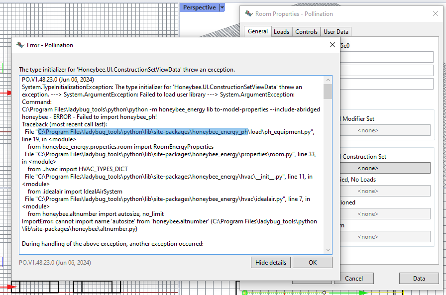

I tried to download the grasshopper honeybee-ph addin through the installer script without success. I then copied the “honeybee_grasshopper_ph” folder containing the “src” and “user_objects” directories to: C:\Program Files\ladybug_tools\grasshopper
This seems to work for the add-in but now it throws the following error in the Pollination Rhino environment:

shoot. Sorry. The only other thing to maybe try, just to see its still a configratiopn problem, is to drag an HB-PH Grasshopper component onto the canvas? If its glowing red and yelling about things, it could still be a config issue. If it works in GH, it must just not be compatible with the Pollination Rhino Tool.
Although… I don’t really understand the error, now as I look at it?
Traceback (most recent call last):
  File "C:\Program Files\ladybug_tools\python\lib\site-packages\honeybee_energy_ph\load\ph_equipment.py", line 19, in <module>
    from honeybee_energy.properties.room import RoomEnergyProperties
  File "C:\Program Files\ladybug_tools\python\lib\site-packages\honeybee_energy\properties\room.py", line 33, in <module>
    from ..hvac import HVAC_TYPES_DICT
  File "C:\Program Files\ladybug_tools\python\lib\site-packages\honeybee_energy\hvac\__init__.py", line 11, in <module>
    from .idealair import IdealAirSystem
  File "C:\Program Files\ladybug_tools\python\lib\site-packages\honeybee_energy\hvac\idealair.py", line 7, in <module>
    from honeybee.altnumber import autosize, no_limit
ImportError: cannot import name 'autosize' from 'honeybee.altnumber' (C:\Program Files\ladybug_tools\python\lib\site-packages\honeybee\altnumber.py)
I don’t see what this autosize object is that is causing the issue?
It is not in the honeybee.altnumber module, unless I’m missing something?
And weirdly, VSCode cannot find it either…
and yet… it does exist in GH…
@chriswmackey , is there some black magic happening here with autosize that I’m missing?

Looking at the traceback, it appears that honeybee_energy_ph might be trying to load the Autosize object from honeybee.altnumber before honeybee_energy has gotten the chance to inject it into the module. This is supposed to happen upon import of honeybee_energy here in the code:
But, for some reason, it is not happening correctly on @smarentette 's machine.
For what it’s worth, I just ran the honeybee-grasshopper-ph installer here using Rhino in Admin mode and I have no issues with either honeybee-ph or Pollination Rhino.
So I am inclined to think, @smarentette, that whatever is preventing you from running the Grasshopper installer correctly on your machine is probably the same thing that is giving you problems with your current installation.
What error are you getting when you try to to run the honeybee-grasshopper-ph installer definition with Rhino in Admin mode?

Now to solve the other problem, as @chriswmackey mentioned, this issue is most likely happening because of the order in which honeybee is loading the extensions. honeybee-energy-ph shows up before honeybee-energy in the list. To fix this add import honeybee_energy._extend_honeybee to the top of C:\Program Files\ladybug_tools\python\Lib\site-packages\honeybee_ph\__init__.py and before importing honeybee_ph modules.
That should resolve the problem.
@edmay, you may want to consider a similar modification in the honeybee-ph source code. Thank you for all the great work!
Thanks, @mostapha . You are right that @edmay needs to make a change to his source code.
I was able to recreate the error. I just needed to run one of the commands that tries to access any of the recourse managers like PO_ConstructionManager.
Because @edmay is importing honeybee energy at the top of extend_honeybee_energy_ph.py, I thought that the import order should be resolving itself. But it looks like he’s trying to access features of honeybee-energy in the other packages he has like honeybee-ph, honeybee-ph-standards, honeybee-ph-utils, and honeybee-ph-hvac. All of them need something that imports honeybee-energy to make sure that the import order resolves itself before these packages start doing their thing. It doesn’t necessarily need to be a direct call to honeybee_energy._extend_honeybee and a simple statement like the following should trigger honeybee_energry.__init__.py in order to extend honeybee:
I’m kinda surprised that this has not come up yet for the other honeybee-ph users but maybe there’s something about the way IronPython 2.7 imports the libraries that helps everyone get lucky that they import in the right order. The same luck does not seem to exist on the cPython 3.10 that we use with Ladybug Tools.
In any event, let us know when you make the change, @edmay .

Still getting an error. I tried (before I saw @chriswmackey comment) this:

You would have to update all 5 of the honeybee_ph packages in order to not get the error anymore, @smarentette . Maybe it’s best to just wait for @edmay to push fixes before you give this a try.
Ah! Thanks for all that info. I will make the update right now.
So the issue is that its trying to load honeybee-ph before honeybee-energy is fully resolved? That makes sense I suppose. Though I agree: its surprising this hasn’t popped up previously? We run honeybee-ph in all sorts of non-IronPython environments and I haven’t run into this before? Curious…
Regardless, I will push this change right now. Do you think the best thing would be add import honeybee_energy to every extension’s root __init__ file? That should trigger the full honeybee_energy plugin load sequence, yes? Or do you think I should include the full _extend_honeybee command within each of my __init__ files?
I initially did a test by just importing honeybee-energy and it didn’t solve the problem. The full version ensures that the libraries get loaded.
Thanks @mostapha
Ok, I think I see the issue here now. You are 100% correct. There are a couple places where importing honeybee_energy withing my honeybee_ph plugin, which is incorrect on my part. I’ll refactor these items properly so that this doesn’t need to happen in the future.
But for now, I have also added the import honeybee_energy._extend_honeybee line first to all of my extension __init__ files. Hopefully this is able to resolve the issue in the short term until I can properly re-work the honeybee_ph modules which are causing this problem.
@smarentette , if you download and run the up to date installer, then copy/paste as you did before (or do the pip install . . . if that is working now following Mostapha’s directions?) then I’m hopeful this might work for you?
Let me know if not, and I can see what else I can do!
