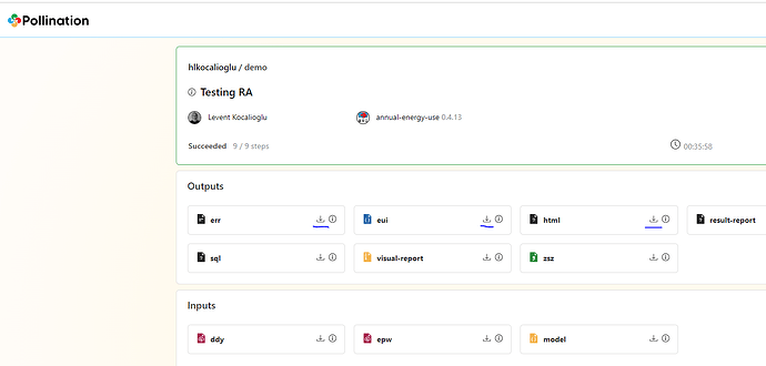

From my experience, you can also use your page on app.pollination.cloud to quickly visualize/download results for cloud simulations. I usually go there to get output files. However, I’m not aware if there is a way to download the entire result folders at once.

For the recipe outputs, you can download all of them with a single click regardless of whether they are files or folders. For the files and folders that are generated during the simulation but are not exposed as outputs, we don’t have an eloquent solution for downloading folders. The main reason for not supporting it is that the folders can get very large, and providing a service to successfully zip and download them is not a trivial task.
