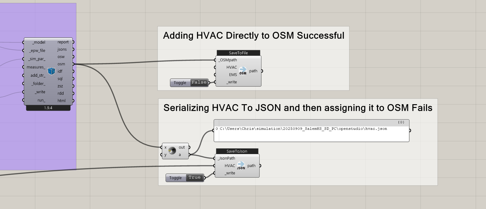

I can see that there is still an issue after updating everything. The problem seems to be in the Ironbug JSON serializer. So I think we will need @mingbo 's help to fix it. I added some components at the end of the Grasshopper file above to help @mingbo test and recreate the issue:
Adding the Ironbug System directly to the OSM succeeds without issues. However, we get the following error when we serialize the IronBug HVAC to JSON and then try to apply it to the OSM:
"C:\Program Files\ladybug_tools\grasshopper\ironbug\Ironbug.Console.exe" in.osm hvac.json

Until @mingbo gets the chance to fix it, you can work around the bug using the Ironbug “Save to File” component like in my screenshot above.

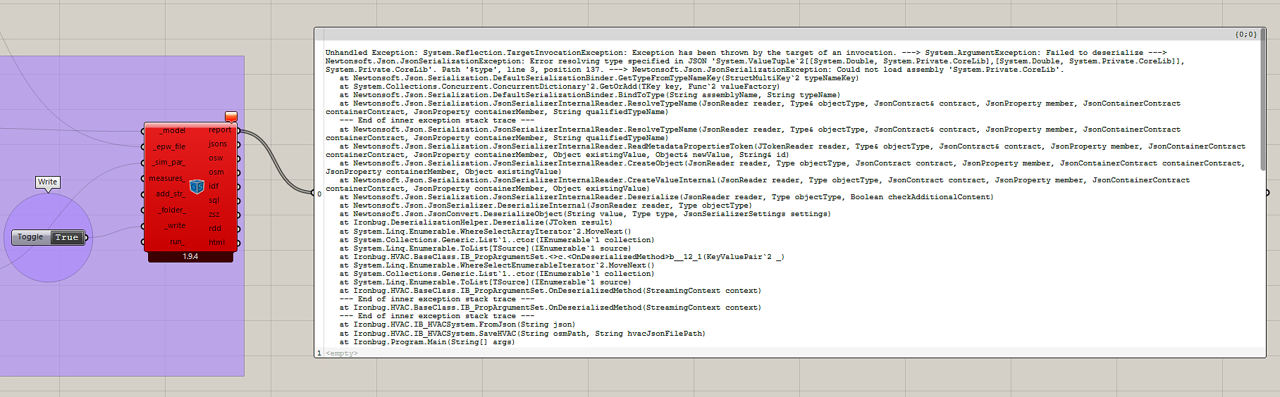

FYI, I also implemented an improvement so that, if this ever happens again, you will get the Ironbug failure message in Grasshopper:
This should help us identify the problem faster next time.
