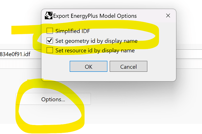

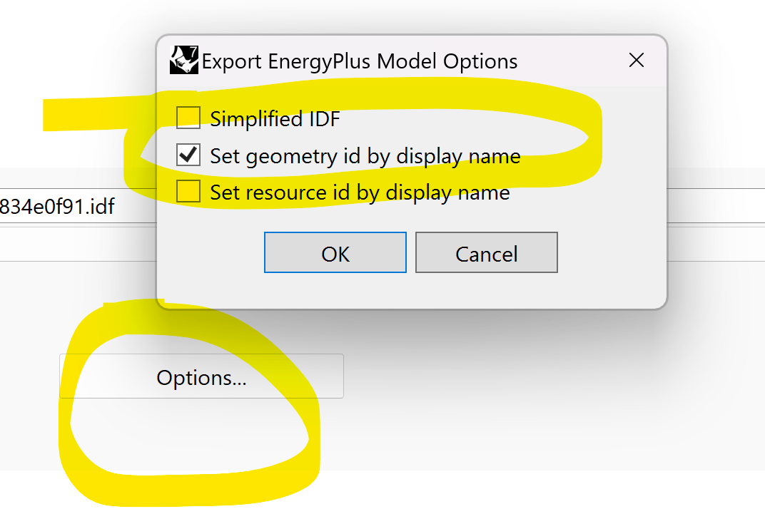

Hi @ishitasingh,
I’ve had the similar problem until I found @chriswmackey’s response below.
https://discourse.pollination.solutions/t/zone-name-issue-in-osm-file/4412/11
Here is the key action when you save the idf file:
Hope this helps,
Levent
Hi @hlkocalioglu ,
Thanks a lot, Levent. That’s very helpful.
