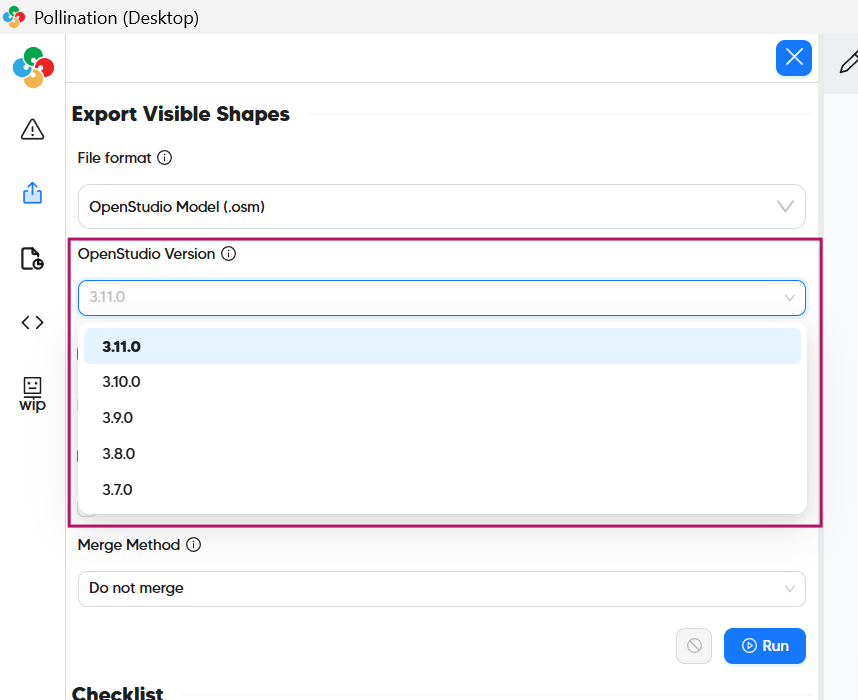

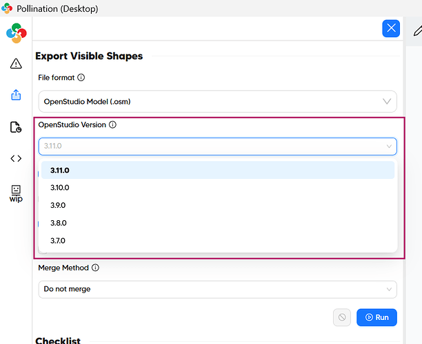

P.S. keep an eye out for the upcoming release. The support for older versions of OpenStudio is finally coming to Pollination. :smiley:
Yay!! I also did use Chris’s link on github to do the backporter so I have it on 3.9 now (look at us! already on 3.9!), but this would just save another step.

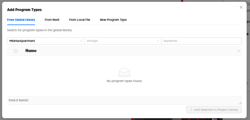

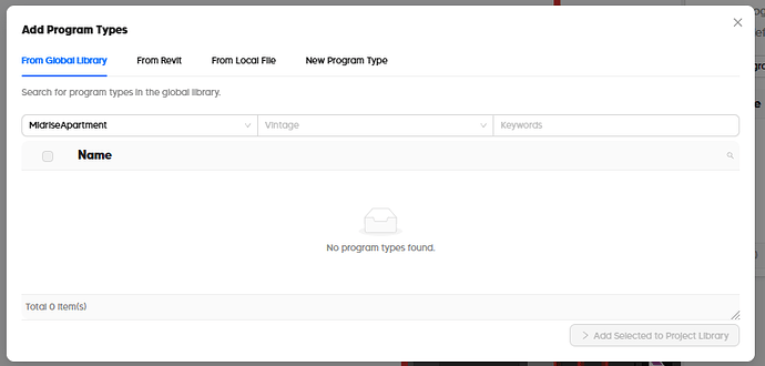

I’ll DM you the json file I got out from your links just to check, but wanted to double check I didn’t miss anything because now no program types are showing ups- even the defaults
I have the program jsons saved in C:\Users\eschwartz\AppData\Roaming\ladybug_tools\standards\programtypes (and construction sets in constructionsets folder, etc)
no rush on this, but can I just jump on a call with y’all at some point to figure out the best way to import programs? I converted all of our osm templates to jsons and got them to show up, but it cant tell the difference between, for instance, the storage spacetypes in the hospital template and the multifamily template and those have different schedules and loads. Whenever works for you!
