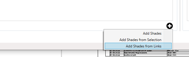

@crduggin, are you selecting the Add Shades from Links option?
If that’s the case, can you share the model with us? The easiest way to get around this issue for now would be to open the linked file and try to export the shades directly.

I believe you should use the Add Shades from Links for selecting the shades from a linked model. @ksobon will correct me if I’m wrong.
That isn’t working either.

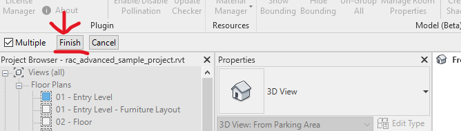

For future reference, this was a UI issue.
After selecting Add Shades from Links you will need to select the shades and then press the small Finish button on the top left of the screen.
That should resolve the issue.
