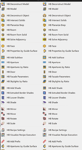

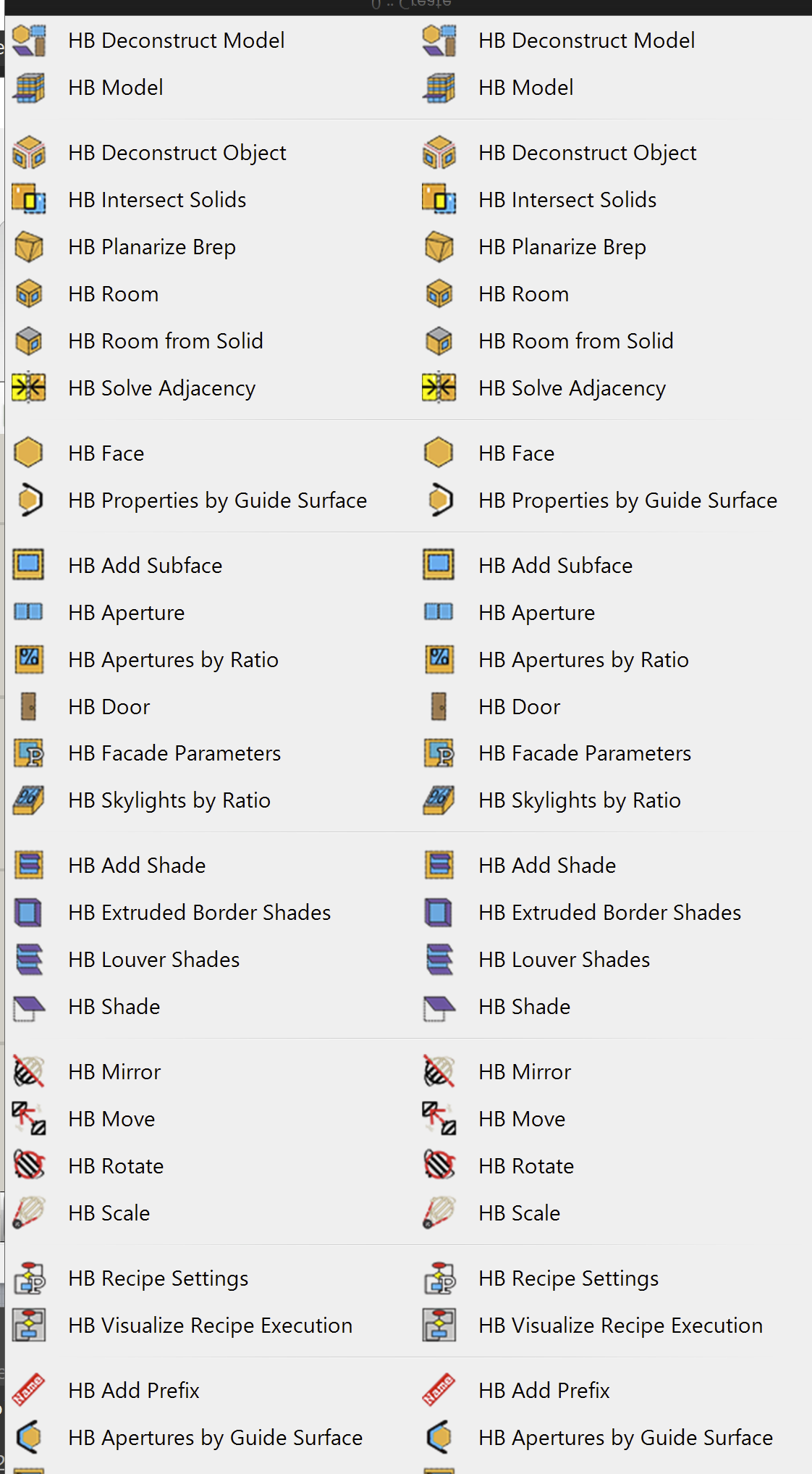

This is my first post! I’ve got a weird issue after installing the Rhino plugin. now I got redundant Ladybug components in GH . see the picture
I had already installed the Ladybug Grasshopper plugin so this might be the issue? but I would like to fix that without messing up with the installation.
Any idea how to fix that?
