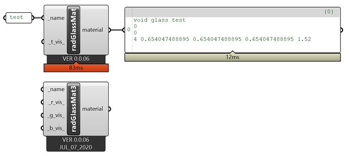

When I looked into this yesterday, I noticed that it took relatively long time (considering the simulation parameters) to throw the message -nan(ind) for only three sensor points. Like in the link above, the results of this job is also -nan. Perhaps this might explain why it takes ~18 hours for the full grid? @monkspaces, can you check the refractive index of your glass modifier?
If the root of the problem is that the refractive index of the glass modifier is below 1, it makes sense that HB[+] can run it since you cannot assign a value of the refractive index in HB[+], i.e., it will be 1.52 by default.

It seems like we are certain that we want to avoid refraction indices less than 1 if they make rtrace go haywire. In this case, I think it would be best for us to enforce refractive indices greater than one via a “greater than” property in the schema and with an exception raised in the core libraries. This should help avoid cases like the one above whether they originate from Grasshopper, Rhino Revit, etc. I also support a warning for refractive indices that far from glass but I sense that it’s still a common use-case for people to change the refractive index to 1.4 in order to model ETFE or even 1.33 in order to model water. Let me first implement the “greater than one” property and then we can circle back to the need for a warning for other cases.

I implemented the check in honeybee-radiance and honeybee-schema, which will ensure refraction_index is always greater than 1:
