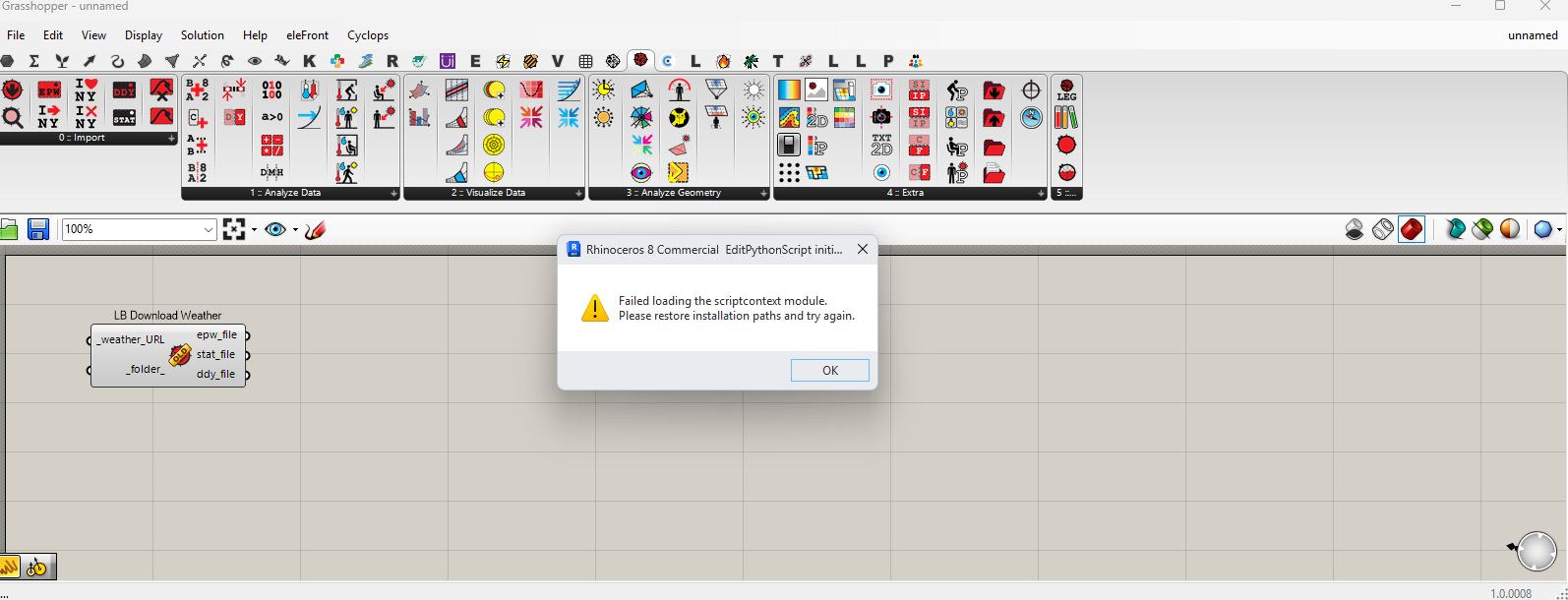

Hello. When I used Pollination Revit and open Rhino using RIR and then open Ladybug tools this issue arises. Ladybug tools not loading in RIR. everthing works well when opened Rhino as stand alone. Already tried reinstalling. I am using revit 2027 and rhino 8 Sr35

Hi @mostapha . I totaly agree that pollination rhino doesnt work in Rhino inside revit. But I am concerned with only ladybugtools in gh. Earlier also I always untick loading pollination. But 1st time I saw basic ladybug tools are failing to load in Grasshopper inside revit. I have some worlkflows from past that easily extracts revit elements and does some basic environmental studies in predesign phase. Doing so in RIR revit models gets updated from rhino isnstantly. Hope atleast ladybug tools works out in gh.It was very well working with Revit 2026 version.

@mostapha the latest hot fix for Rhino 8.36 has solved this issue. LBT loads now!

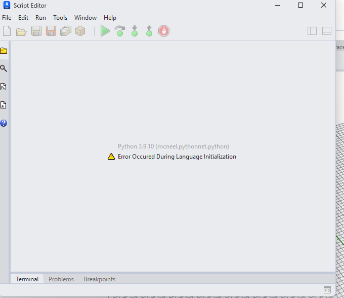

I have installed the very last Rhino version [Version 8 SR36 (8.36.26279.7001, 2026-10-06)] + the latest LBT version [1.71.2.0, Oct 09, 2026] and this is what i get [unfortunately]:

The hotfix was not officially publicaly realeased as of yesterday @ayezioro
They just sent me the hotfix. It is rhino_en-us_8.36.26282.15001
LBT is back :slight_smile:
