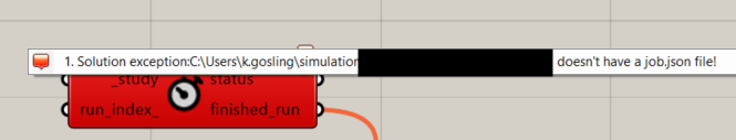

When searching for the study using the ‘Check Study Status’ component I get the error below. (I’ve had to redact part of the file-path in line with my company’s privacy policy)
I’ve seen in responses to other questions that this is a known issue for runs that fail, and that it was being looked at. Looking through the other in the study folder, it seems like all the information for a study is present, and seems to have run successfully, but there is no job.json file.

Hi @kyrangosling10,
Welcome to the forum. Both of these issues have been resolved.
See here:
https://discourse.pollination.solutions/t/userwarning-pkg-resources-is-deprecated-as-an-api-pollination-component-run-error/12157/9
And here:
https://discourse.pollination.solutions/t/parametric-local-studies/10760/11
Try to download the latest version of the plugin (v1.64.5), and both issues should be resolved.
