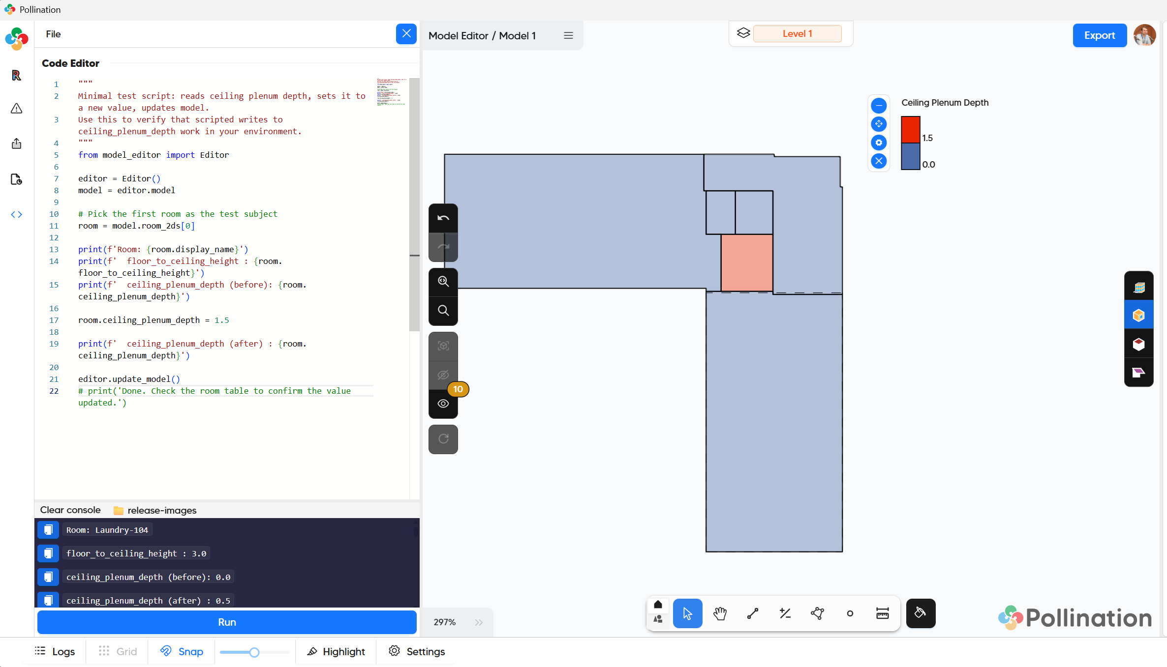

Hi @gregatze,
This looks like a bug in the editor. I’m not sure why but the last print statement overwrites the update. Try commenting out the last print and it should work as expected.
Here is a screenshot of my test.

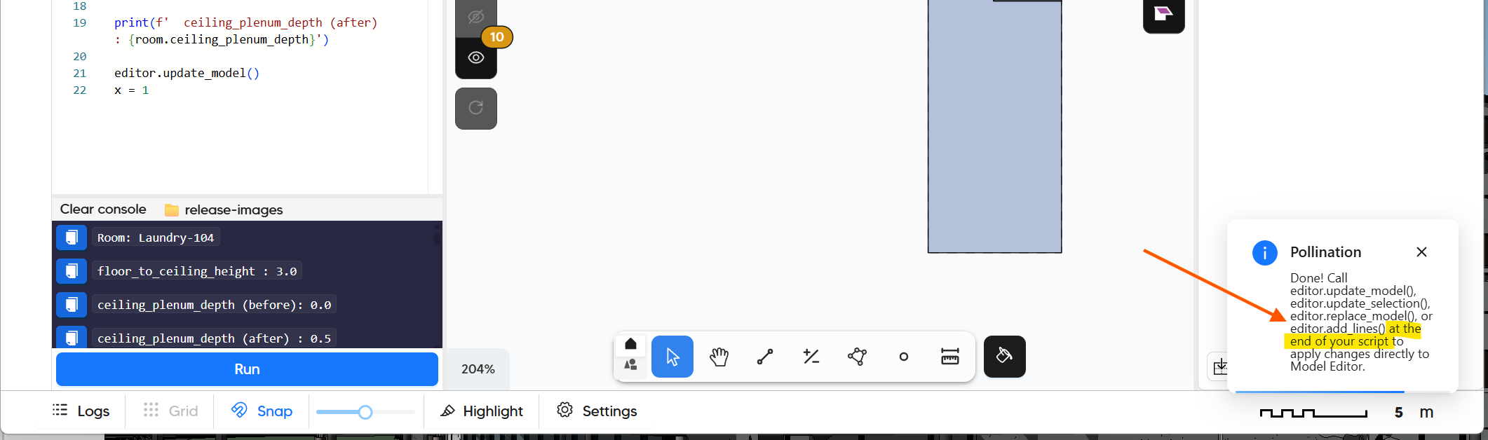

Letting Model Editor create plenums is probably 1000x faster than doing the same thing in IESVE. Thanks for the massive time savings!
I just noticed that we do have a warning but it is very easy to miss. :backhand_index_pointing_down:
@antonellodinunzio, we should make this more explicit. I would say, we should give the user a validation error in the scenarios like this or make the editor smart enough not to allow writing code after the update. Or hide the update_model from the user and add it to the script under the hood. If we decide to hide it, then we most likely need to have it in the settings.
