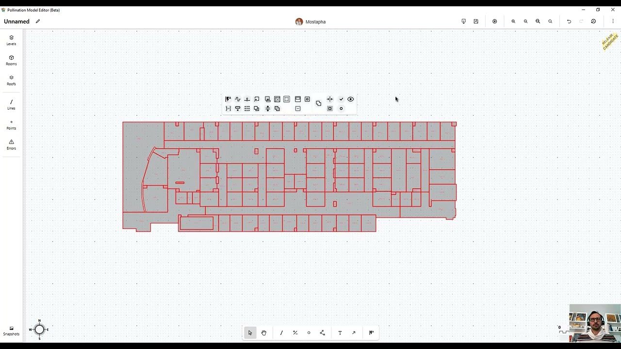

  • Edit the models [much] faster: We added several new automated commands. Editing the models inside the Model Editor is much faster. For most models, you should only need a few clicks.
  • Keep track of the changes: We add the color-by-attributes feature to the Model Editor. You can keep track of several attributes, including the area change as you clean up the model.
  • Clean up the curved edges easier: We added a new command to simplify curves, and a new workflow for aligning them to polygons.
Here is a recording that provides an overview of the new commands. In particular, you might be interested to see how the clean up time for the Advanced Revit sample goes from ~20 minutes to ~2 minutes!

Auto Align
This command introduces a healthy level of :magic_wand: magic to the alignment process. It automatically identifies the common axes among the selected rooms and aligns the rooms to them with a single click.
See this link for the command detailed documentation.
