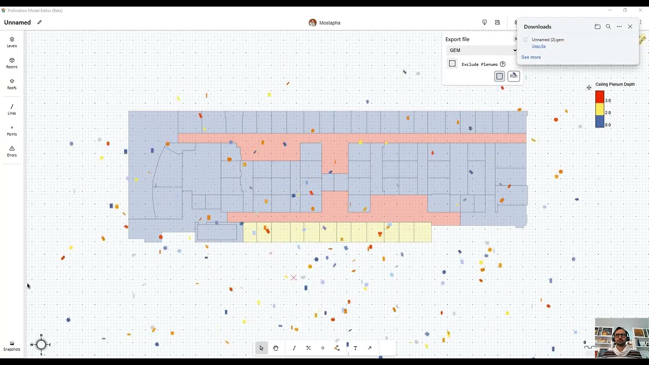

There are 3 ways to check the plenums before exporting the model:
Use Alt + P to highlight the rooms with plenums.
Use Color-by to color the rooms by plenum depth.
Use the 3D preview to visualize them in 3D.
