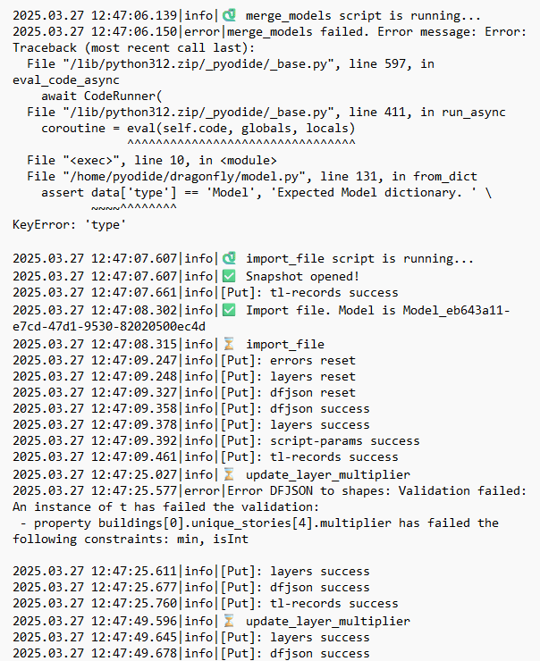

I am receiving an error when I try to export the model using multipliers for some floors, this is a screenshot from the log:

Hi @priyakc,
I was able to recreate the issue. The issue is with the multiplier menu, and is not specific to your model. I documented the issue for @antonellodinunzio, and we will let you know once the issue is fixed.

Hi @priyakc, this should be fixed now. Try to reload the Model Editor, and then you will be able to use the multipliers. Let us know if you face any issues.
