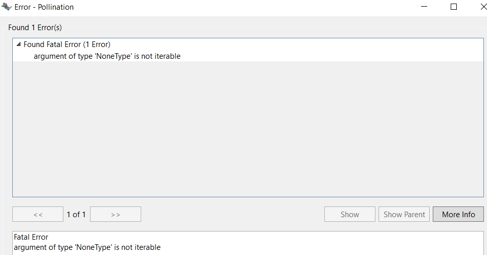

NoneType Error during Model Validation
Hi guys,
Have you encountered this error before? I can’t seem to find a fix for this even in the Pollination solutions site. Any help would be appreciated. Thank you!
Hi @alvinv, it’s hard to tell without seeing the model. Can you share the Rhino file with us?
Hi Mostapha, I did a quick check of the rooms modeled and saw a room that’s in wireframe unlike the rest. It’s a clickable room space but is not reflected in the Room Manager. I just had to delete it and re-model again. When I re-validated the model, the fatal error is gone.
Anyways, thanks for reaching out!
