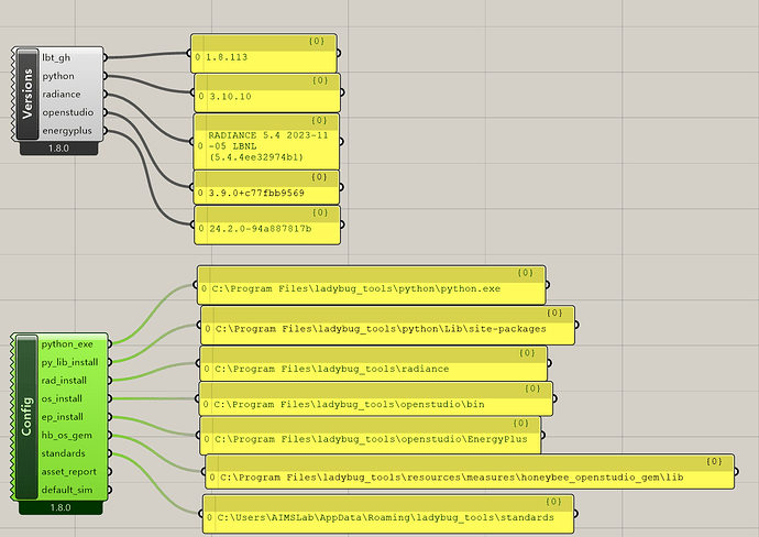

Hi everyone,
I’m encountering an issue while setting up my simulation environment using Pollination Grasshopper.
Here’s what I intended to do:
  1. I used Pollination Grasshopper to install and integrate Ladybug Tools, OpenStudio, and Radiance.
  2. The installation seemed to complete, but OpenStudio doesn’t appear to be working correctly.
Here are the versions currently installed on my system:
  • LBT_gh: 1.8.113
  • Python: 3.10.10
  • Radiance: RADIANCE 5.4 (2023-11-05) — LBNL 5.4.4ee32974b1
  • OpenStudio: 3.9.0+c77fbb9569
  • EnergyPlus: 24.2.0-94a887817b
Has anyone experienced a similar issue?
Is there anything I should double-check in the installation process or compatibility between these versions?
Any advice or guidance would be greatly appreciated!
Thanks in advance.

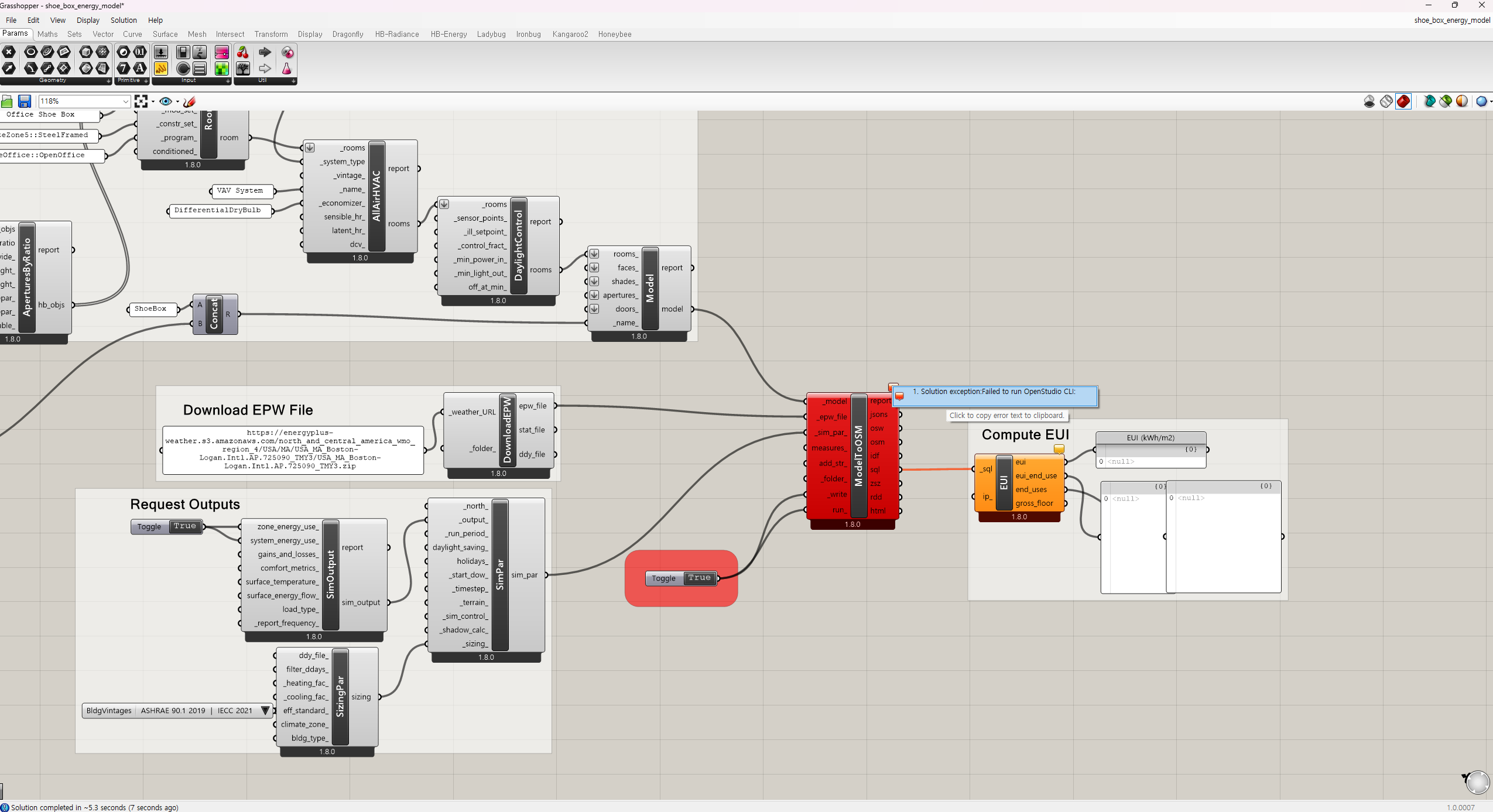

Hi Chris,
I still can’t get OpenStudio 3.9 to run after running the LB sync grasshopper file. (example file attached).
It sounds like others can run my script fine, which sounds hopeful, but I’m completely stumped as to why OpenStudio keeps cutting out a few seconds after running.
Do you have any suggestions as to why OpenStudio persists to cut out?
many thanks.
Room energy model.gh (218.3 KB)
Hi @robm ,
Your file runs fine for me:
So there is probably something wrong with your installation. Uninstalling and reinstalling via the pollination installer has a good chance of fixing it. If not, you will need to send us your error message for me to have any idea of what is going wrong on your machine.
