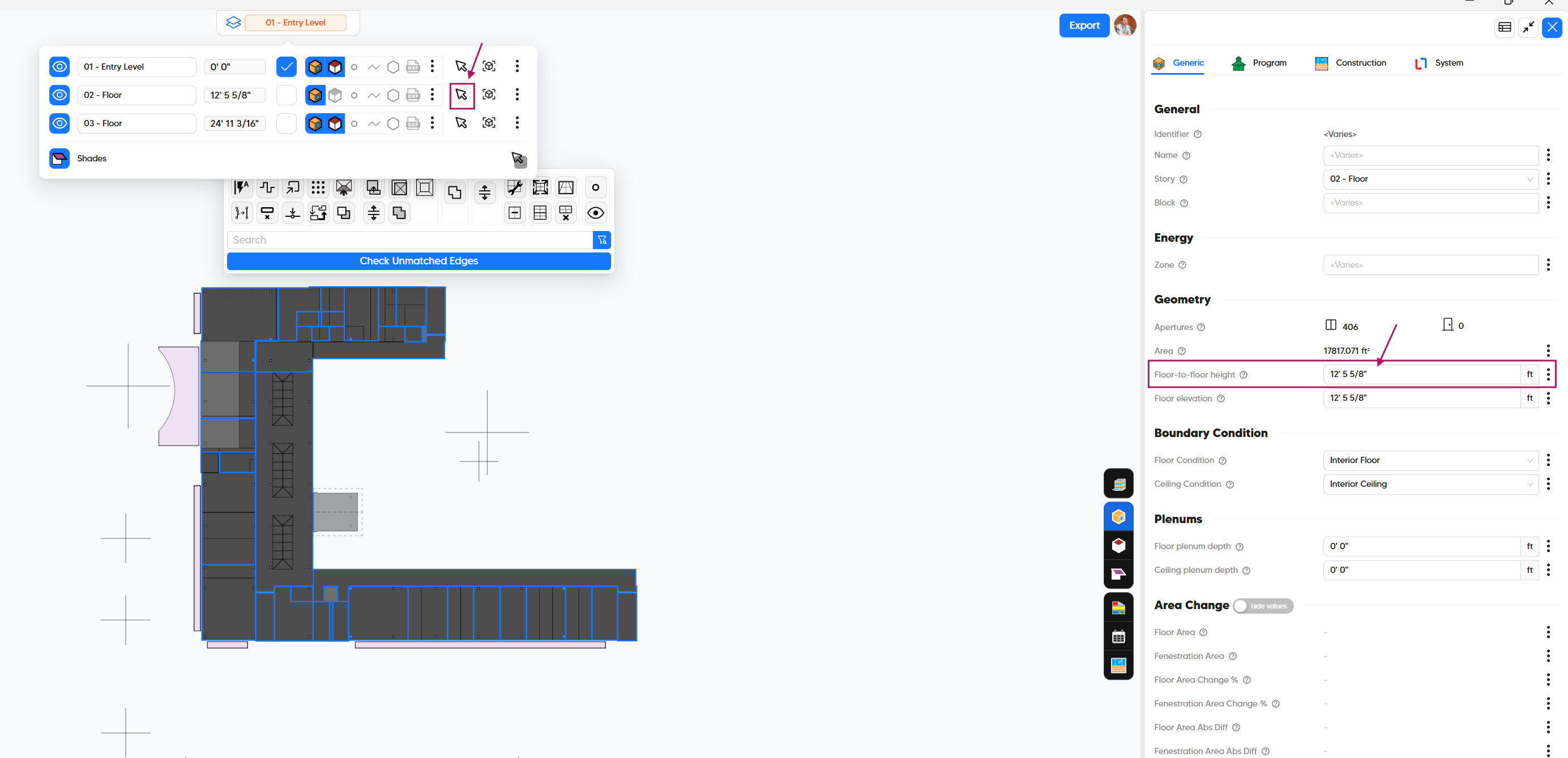

Hi! When I export rooms from ‘top of room slab’ the rooms are vertically overlapping with the level before that. The elevations seem to be correct. How can I fix this? Thank you!
Hi @cemresonmez,
The easiest way is to change your input value for extrusion height to the correct value.
In case you have already cleaned up the rooms and don’t want to re-import them, you can select all the rooms in the level, and change the value for floor-to-floor height.
