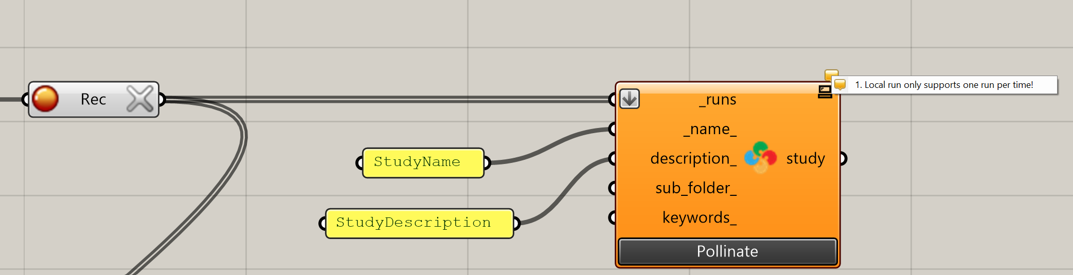

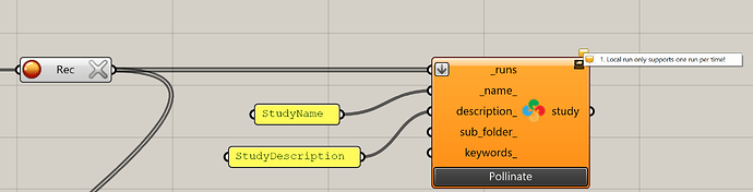

Regarding the question about running a study with more than one run locally, I always get the following error message when I try:
@davidjbrownstein, have you had the same experience?
@mostapha, I may not be on the most up to date version of Pollination.

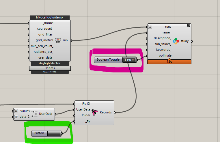

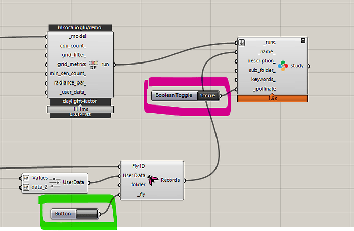

Hi @anthonyschneider, you will get proper answer from the team but from my understanding, when you are running a parametric study locally, you need to do two things:
  • Enable pollinate input (right click on the Pollinate component)
  • Enable fly input (right click on the fly component)
By doing this, you should be able to run multiple studies locally without any issue.
Hope this will be helpful,
Levent

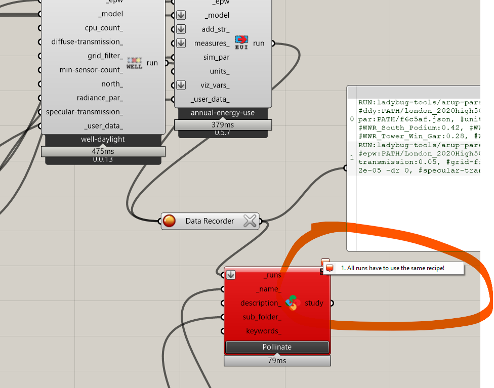

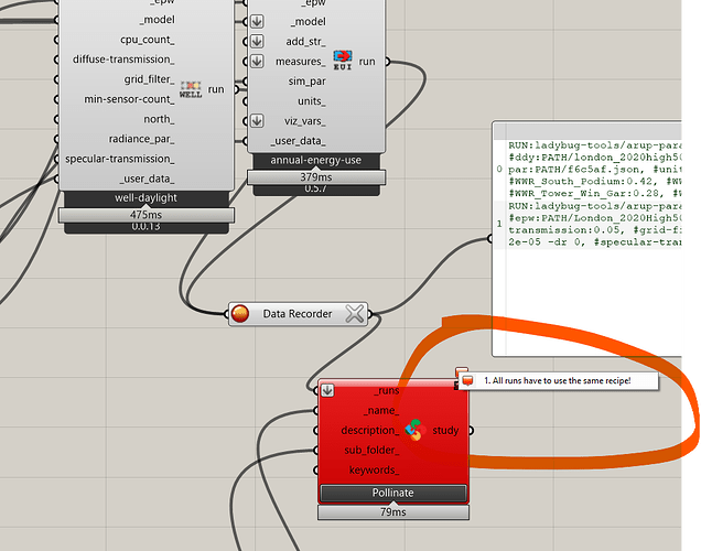

Thanks all for the responses. I get exactly the same result as shown in @anthonyschneider screenshot. When using data recorder to plug in a number of runs, it shows this as not being possible.
I could do what @hlkocalioglu suggests, which will create separate studies for each iteration (rather than runs), but then I run into the issue of fetching the results as they are all separate studies. Whereas I can only get the results of one study at a time.
Thank you all! I had to reset my memory to remember how the local runs are set up. You’re correct that you can only schedule
Supporting more than one run in study takes some reworking of the code that schedules and runs the studies. I haven’t checked the code for some time and I can’t really help with giving an estimate on how much it would be or when we’re going to get around it. That said, you should be able to run the studies, and load the results from several studies, and compile them back together.

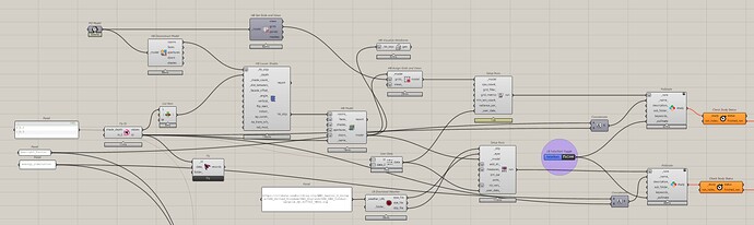

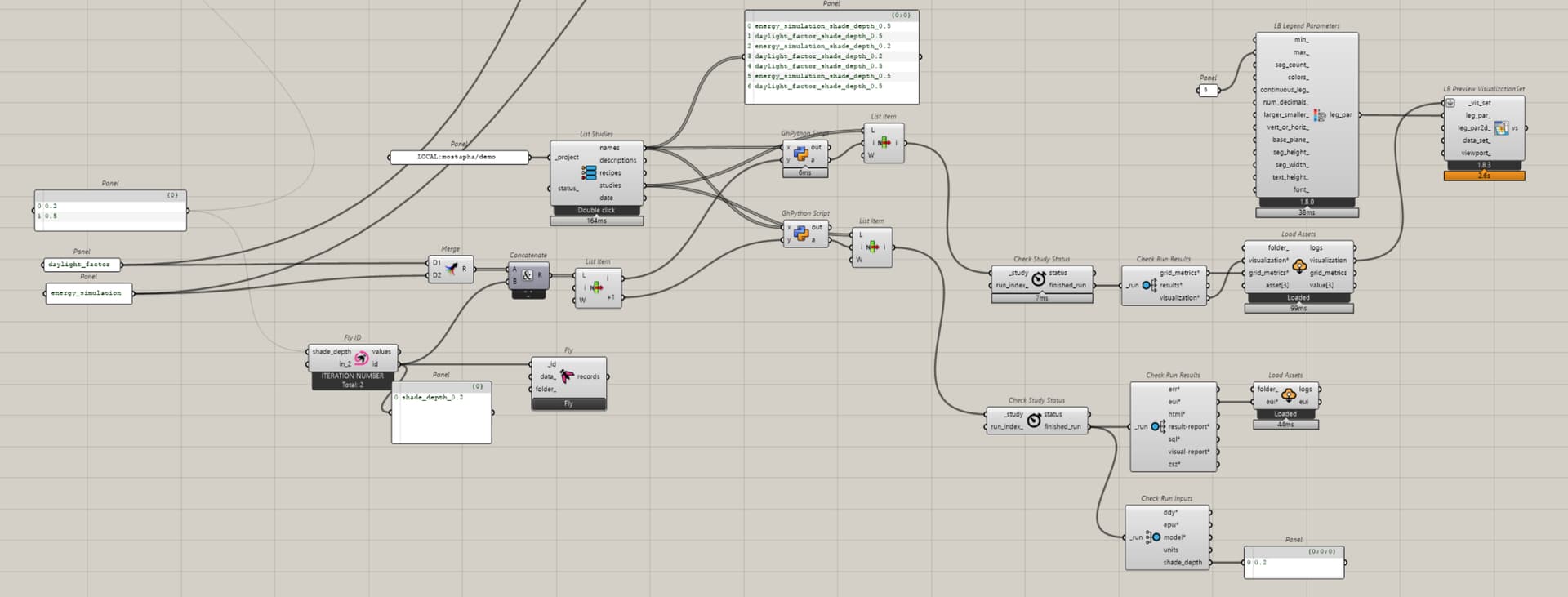

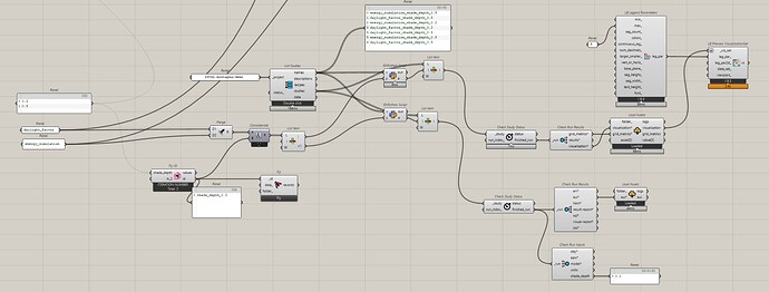

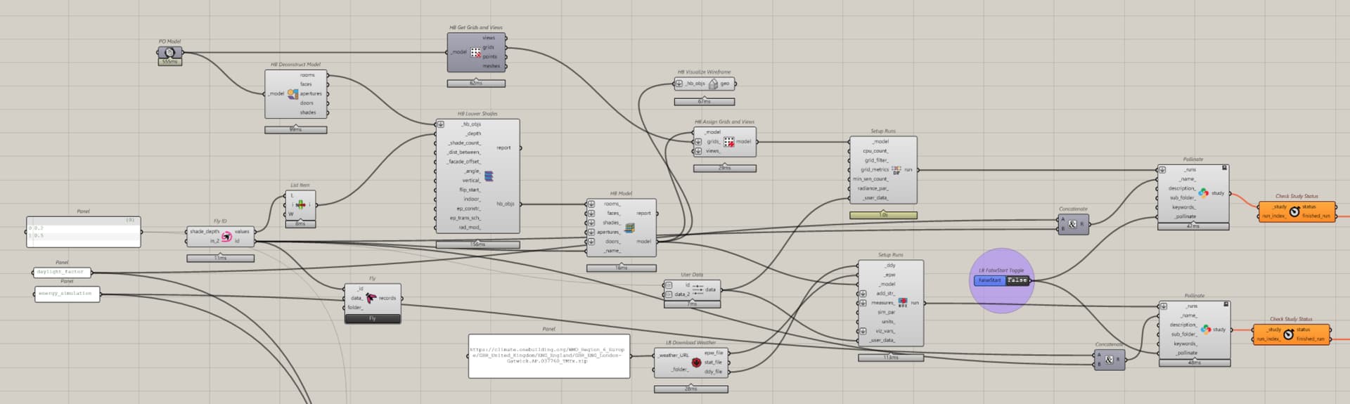

Here is the sample file:
parametric_study_add_shade_1.gh (84.1 KB)
And a recording that walks you through the process.
The file has two sections for setting up the studies:
And loading the results:
