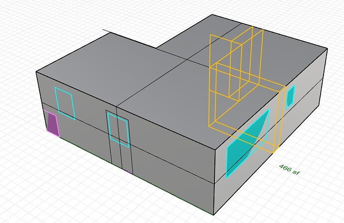

Am I able to add partitions to my model in rhino for IESVE export?
Hi @kbren, you might get a better response from the team but I always find PO_SplitRooms command useful choosing with line=draw option for creating partitions before export.
Hope this helps,
Levent
Hi @kbren, from what I can see partitions are the same as interior walls. If that’s correct, then you can follow @hlkocalioglu’s suggestion to split your room into smaller rooms.
